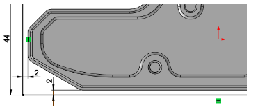

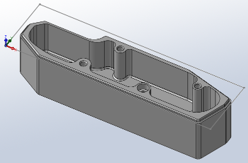

  2. Step 2: Sketch the Stock
    Since we need an entity to place our origin on, and because having the stock defined makes the stock simulation more accurate, we will set up the stock for this part.
    When you have a part without any geometry at the machining origin, or if there are no planes in the machining direction, you may need to construct helper geometry to be used from HSMWorks.
    This part, for example, we want to machine from a rectangular block of aluminum which is slightly larger than the part, and for easier setup we want keep the tool orientation origin at the corner of the stock piece.
    There are two ways to set up a stock in an assembly:
    ➝ Create a separate model representing your stock (See Tutorial 3 - 3+2 Machining for an example of this)

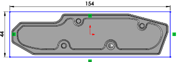

    ➝ Create a 2D sketch of the stock silhouette. This works well if your stock is simple - like a block or a cylinder.

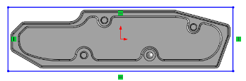

    Create a rectangular sketch, representing a block of stock measuring 154mm by 44mm (ie. slightly larger than the extends of the part):

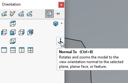

    ➝ Select the flat face on the top of the model:
    ➝ Start a new Sketch on this face, available from the Insert menu or the Sketch toolbar
    ➝ Change the view to Normal To.
    ➝ Press Ctrl+8 or choose from the View toolbar:
    ➝ Start sketching a rectangle.
    ➝ Sketch a rectangle enclosing the entire model, like this:
    ➝ Using the Smart Dimension tool, add dimensions to the stock sketch, like this:
    ➝ Optional: Add extra dimensions between the sketch and the part, to fixate it:
    ➝ Now, finish the sketch

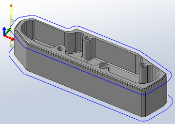

  5. Step 5: 2D Contour
    First of all we want to machine the outer planes of the part. We want to run the tool along the outer edges of the part.
    ➝ Click 2D Contour on the CAM toolbar or select it from the CAM, Toolpaths menu.
    This creates a new operation, and opens the Property Manager where you can edit the individual parameters controlling the toolpath, as well as selecting the actual geometry to machine.
    The property page is divided into a number of groups, and in this tutorial we will go through each one by one, changing the necessary settings in each group as we go along.
    1. Tool
    ➝ Press Library
    ➝ From the library Tutorial under Sample Libraries, select tool #3 - Ø10mm flat
    ➝ Press Select

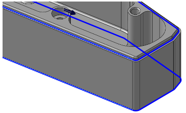

    2. Geometry

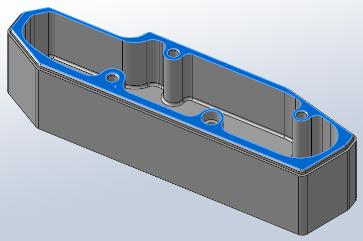

    We want to machine around the outside outline of the part. To do this, select a chain of edges from the model:
    ➝ Click the Geometry selection field
    ➝ Select the bottom front edge on the model:
    ➝ If the direction arrow does not appear as shown, change the direction by clicking Reverse
    Notice that HSMWorks automatically creates a chain around the part. This is because Tangent propagation and Propagate along Z are enabled by default.
    Depending on which end of the edge you click you can determine the direction of the contour. By clicking closer to the desired start of an edge you can determine the direction of the contour. For climb milling click close to the bottom right side of the edge.

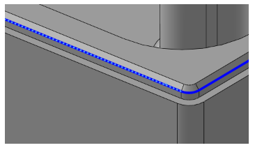

    We can machine the indent around the top of the part in the same operation:
    ➝ Zoom in on the top right corner of the part
    ➝ Select the edge inside the indent:

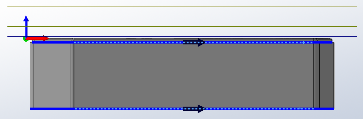

    3. Heights
    By default, the heights for the 2D Contour operation is set so the bottom of the toolpath is at the level of the selected contours, and the remaining heights depend on the stock and model geometry.
    If you look from the side of the part (press Ctrl+6), it should look like this:
    These defaults are fine in this example, and we do not need to change them.
    4. Start calculation
    Click at the top of the property manager. This will automatically start calculation of the toolpath.
    The toolpath will now be calculated and a preview will be shown in the model view:

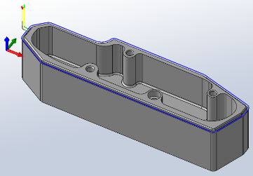

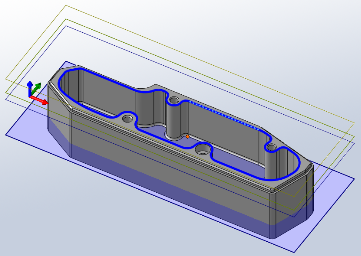

  6. Step 6: Pocket Machining
    As the next operation we want to machine the internal pocket of the part. In this operation we will use the 2D Pocket strategy with a 10mm bull nosed tool with a 1mm corner radius.
    ➝ Click 2D Pocket on the CAM toolbar or select it from the CAM, Toolpaths menu.
    1. Tool
    In this operation we will use a tool with a corner radius of 1mm to match the fillet radius at the bottom of the pocket.
    ➝ Press Library
    ➝ From the library Tutorial under Sample Libraries, select tool #11 - Ø10R1mm bullnose
    ➝ Press Select

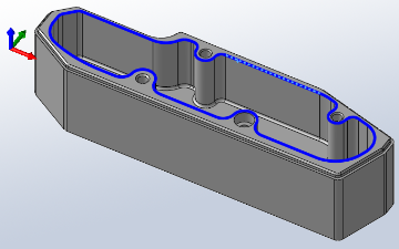

    2. Geometry
    In this group we select the contour of pocket we want to clear.
    ➝ Make sure that both Tangent propagation and Propagate along Z are enabled for simpler chain selection
    ➝ Select one of the edges at the top of the pocket
    The selection should now look like this:
    3. Heights
    The parameters in this group control the different height where toolpath is generated.
    In this example, we want the 2D Pocket operation to machine down to the bottom of the inside cut.
    ➝ For Bottom choose From Selection.
    ➝ For the Bottom Reference select one of the vertices along the bottom face:

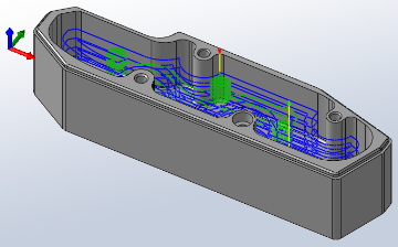

    4. Passes
    2D Pocket
    This group controls how the 2D pocket toolpath will be calculated. We want to use this pocket toolpath to clear out the pocket. To do this we want to generate the toolpath in a number of z levels, starting from the top of the stock and going down in steps of 2mm to the bottom of the pocket. The depth of pocket is 25mm.
    Change the following parameter values, and leave all others at their default:
    ➝ Set Maximum Stepover: 5.0mm
    ➝ Enable Multiple Depths
    ➝ Set Maximum Roughing Stepdown: 5.0mm
    ➝ Set Finishing Stepdowns: 2
    Stock to Leave
    We want to leave some stock on the sides, as we will need to finish the fillets with a smaller tool later on anyway.
    The bottom, however can be finished by the pocket, and we should remove the vertical stock to leave:
    ➝ Set Axial (Floor) Stock To Leave: 0.0mm
    5. Linking
    Assuming that this part is made of a soft material, where we can do full width cuts, we can avoid some ramping by allowing the tool to stay down inside the pocket:
    ➝ Enable Keep Tool Down
    ➝ Change Maximum Stay-Down Distance: 250mm
    Leads & Transitions
    We will leave all settings in this group unchanged. We will use a helix ramp for plunge to material with the default settings from the program.
    6. Start calculation
    The toolpath will now be calculated and shown in the graphic area. The toolpath should look like in the picture below:

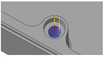

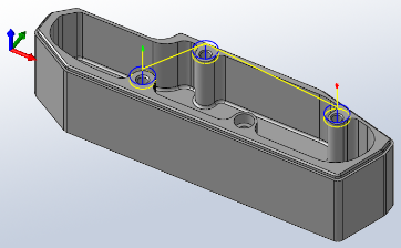

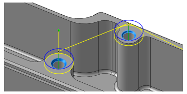

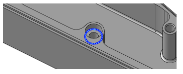

  7. Step 7: Drilling
    There are four holes in the part. One is clear and three are with thread. First, we will drill the three holes with a 4.3mm drill.
    ➝ Click Drill on the CAM toolbar or select it from the CAM, Toolpaths menu.
    1. Tool
    ➝ Press Library
    ➝ From the library Tutorial under Sample Libraries, select tool #34 - Ø4.3mm drill
    ➝ Press Select
    2. Geometry

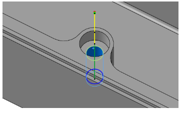

    Select the cylinder of one of the three 4mm holes
    ➝ Check Select same diameter
    If Select same diameter is disabled (grayed out), you have most likely selected the edge of the cylinder instead of the face. You need to select cylindrical faces to use this feature.
    When selecting faces instead of edges, it has the added benefit that the depth of each hole is automatically determined from the height of the cylinder.
    Depending on the selection, you may want to enable Optimize order. The optimization reorders the holes in order to make the linking distance as short as possible.
    If you check Order by depth, this will keep holes with the same depth and plane together. This may reduce the number of cycles in the output, but may not result in the shortest toolpath, even if Optimize order is enabled.
    3. Heights
    This group controls the heights of each hole, and the heights used when moving between the holes.
    Because of the chamfer on the holes, the cylinders start a bit lower, and we will adjust for this by making the top start from the top of stock instead:
    ➝ For Top select From Stock Top
    Having selected cylinders for our holes, all heights are relative to the top of the cylinder, and the depth is relative to the bottom.
    This allows us to avoid entering the depths of the holes manually. If we had selected edges (which do not have a height), we would have to enter the depth manually.
    4. Passes
    Cycle
    In this group select type of the cycle Chip breaking - partial retract.
    ➝ Change Pecking Depth: 2.5mm

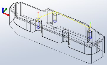

    5. Start calculation
    This will calculate the toolpath, which should look like this:
    Drilling toolpaths are often best seen on a wireframe model.
    Select Wireframe from the View, Display menu or the View toolbar to change to wireframe mode.

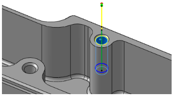

  8. Step 8: Tapping
    This tapping operation only differs in the type of cycle from the previous drilling operation; tapping will be done for the same geometry. To save all the work of entering this data, we will just copy the existing drilling toolpath and create the tapping toolpath by editing this copy.
    ➝ Right-click on the toolpath Drill1, select Duplicate (This creates a copy of the operation below the original one)
    ➝ Right-click on the new operation (Copy of Drill1)
    ➝ Choose Rename
    ➝ Type the new name, e.g. Tapping M5
    Now we have to change the parameters and settings of the operation:
    ➝ Right-click on Tapping M5
    ➝ Select Edit from the context menu
    1. Tool
    ➝ Press Library
    ➝ From the library Tutorial under Sample Libraries, select tool #43 - Ø5x1mm right tap
    ➝ Press Select
    2. Heights
    Now, to avoid breaking the tap, we need to reduce the depth so it is less than the drilled depth:
    ➝ Change Bottom: 2.0mm
    This will reduce the depth by 2mm.

  9. Step 9: Drilling 2
    Next, we need to drill the single 4.5mm hole.
    1. Tool
    ➝ Press Library
    ➝ From the library Tutorial under Sample Libraries, select tool #33 - Ø4.5mm drill
    ➝ Press Select
    2. Geometry
    Select the lower cylinder of the last hole
    3. Heights
    Because of the counter sink on this hole, the cylinder start a bit lower, and we will adjust for this by making the top start from the top of stock instead:
    3. Passes
    All other setting in the groups can be left unchanged.
  10. Step 10: Circular Pocket Machining
    To machine the counter boring on the single 4.5mm hole, we will use a the 2D pocket strategy with a 4mm flat end tool.
    1. Tool
    For this pocket we need a flat tool with a diameter less than 4.5mm so we can plunge into the pre-drilled hole.
    ➝ Press Library
    ➝ From the library Tutorial under Sample Libraries, select tool #5 - Ø4mm flat
    ➝ Press Select
    2. Geometry
    ➝ Select the edge at the bottom of the counter-sink:
    3. Passes
    2D Pocket
    ➝ Set Maximum Stepover: 0.5mm
    Stock to Leave
    ➝ Disable Stock To Leave
    4. Linking
    Leads & Transitions
    To make sure that we plunge at the center of the hole, we will disable the lead-in:
    ➝ Disable Lead-In (Entry)
    And to get a smoother exit can adjust the lead-out a bit:
    ➝ Set Horizontal Lead-Out Radius: 1.0mm
    ➝ Set Linear Lead-Out Distance: 0.0mm
    Since we have already drilled at this position, we can make the tool plunge into the drill hole:
    ➝ For Ramping select Plunge
  11. Step 11: Counter Sinking
    Three of the drill holes have small counter sinks. We can machine all three in a single Drill operation by using a Counter Sink tool.
    1. Tool
    ➝ Press Library
    ➝ From the library Tutorial under Sample Libraries, select tool #60 - Ø10mm 90deg counter sink
    ➝ Press Select
    2. Geometry
    ➝ Select the counter sink faces of the two first holes:
    The counter sink face of the third hole should be automatically selected since it is identical to the second.
    3. Start calculation
  12. Step 12: Chamfering
    To machine the chamfer along the outside edge we can use the 2D Contour strategy with a chamfer mill.
    1. Tool
    ➝ Press Library
    ➝ From the library Tutorial under Sample Libraries, select tool #50 - Ø10mm 45deg chamfer
    ➝ Press Select
    2. Geometry
    In this model, the chamfer already exists as a part of the model, which means that we have two edges to choose from as the geometry. One at the top of the chamfer and one of the bottom. HSMWorks allows either to be used, but in most cases choosing the bottom one allows for the easiest setting of parameters. In both cases, however, HSMWorks will automatically calculate the correct horizontal offset, and you only have to enter the additional vertical tip offset.
    3. Passes
    2D Contour
    When choosing a Chamfer Mill as the tool, the Chamfer option was automatically enabled, thereby showing the chamfering parameters Chamfer Width and Chamfer Tip Offset.
    Since we have chosen an edge on an actual chamfer feature in the model we don't have to set the Chamfer Width, but we do need to set the Chamfer Tip Offset so that the tool tip is not coincident with the lower edge of the chamfer:
    ➝ Set Chamfer Tip Offset: 0.25mm
    This completes the toolpaths for this part and you can now simulate and post-process the result.
