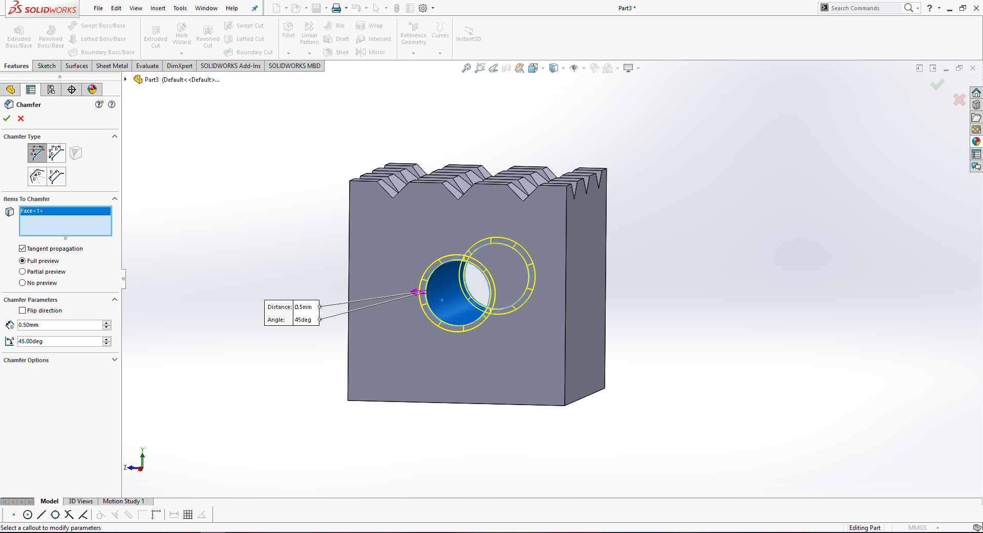

- Create chamfers on the selected edges.
- We'll have something that looks like this.

Step 3: Clamp Foot

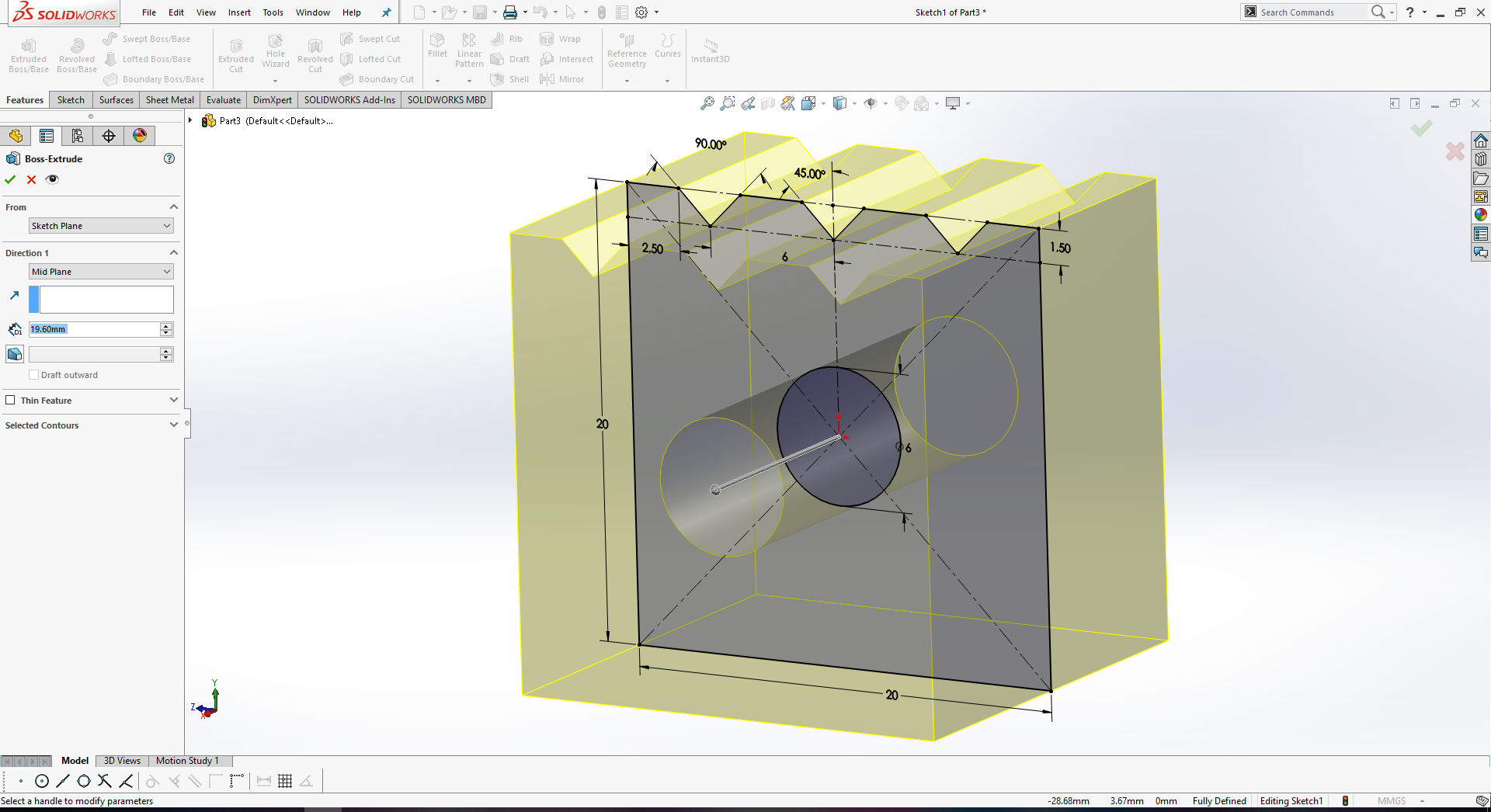

- Select the right plane and draw the sketch below.
- Extrude 19.6mm from the midplane.
- Select the front plane and draw the sketch below.
- Extrude cut the selected contours through all both side.
- Create chamfers at the selected edges.
- Select Matt Steel as material (not mandatory).
- Select color (not mandatory).
- Save the part as Clamp Foot.

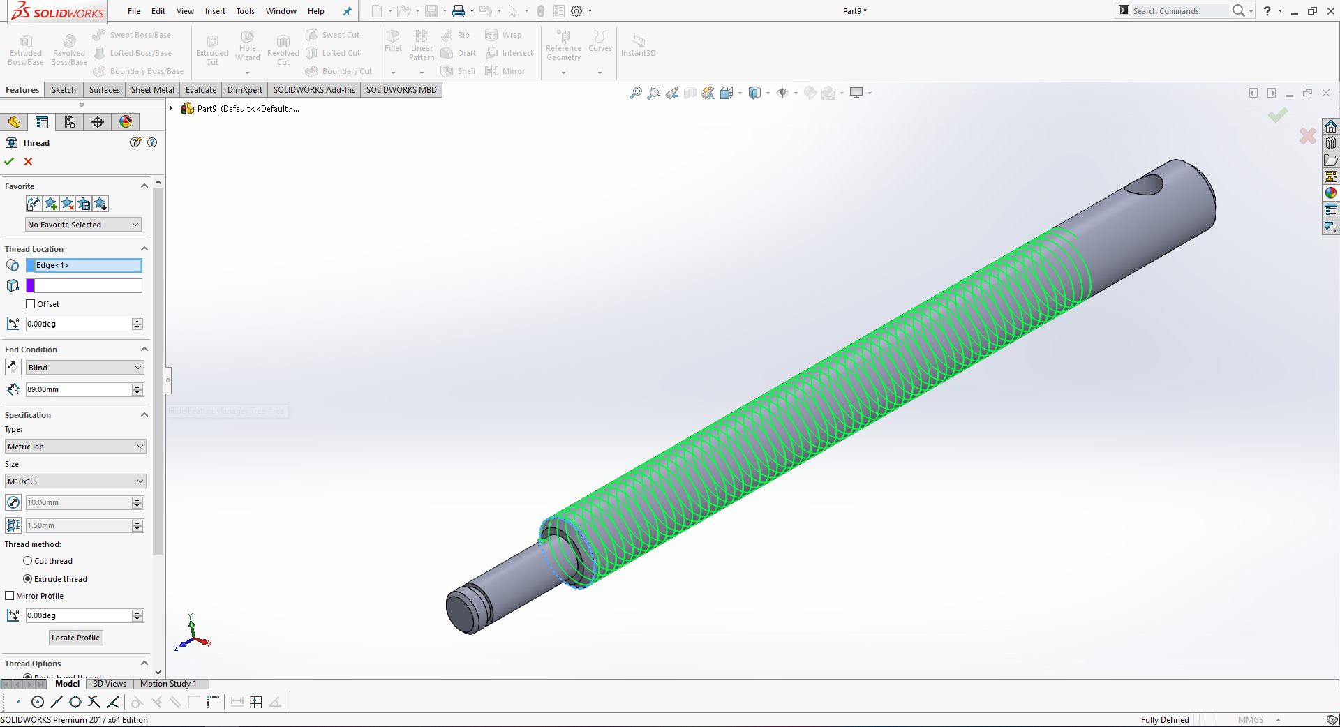

Step 9: Clamp Rod

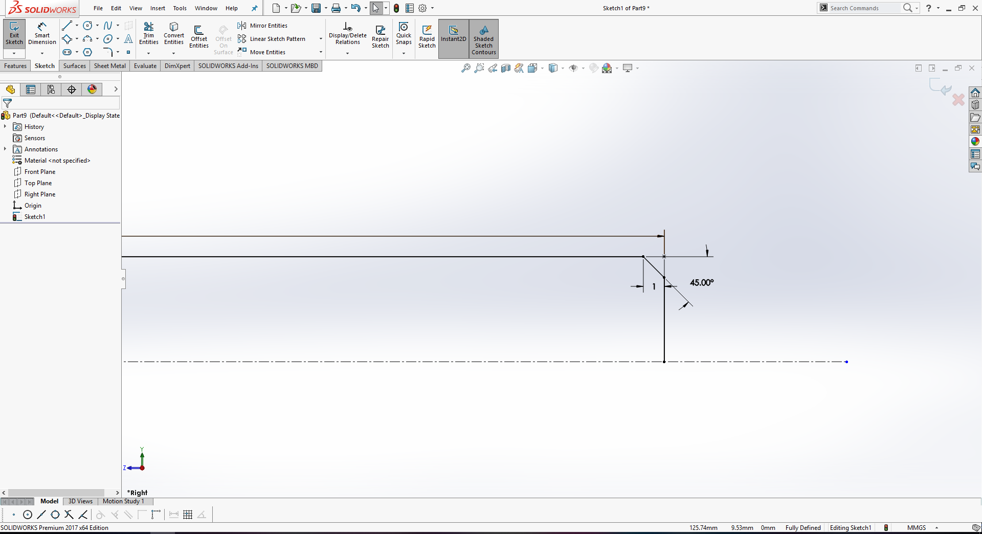

- Select the right plane and draw the sketch below. Then revolve around the center line.
- Select the top plane and draw the sketch. Then extrude cut through all both side.
- Extrude thread using the below data.
- Create chamfer at the selected edges.
- Select polished steel as material (not mandatory) and save as Clamp Rod
