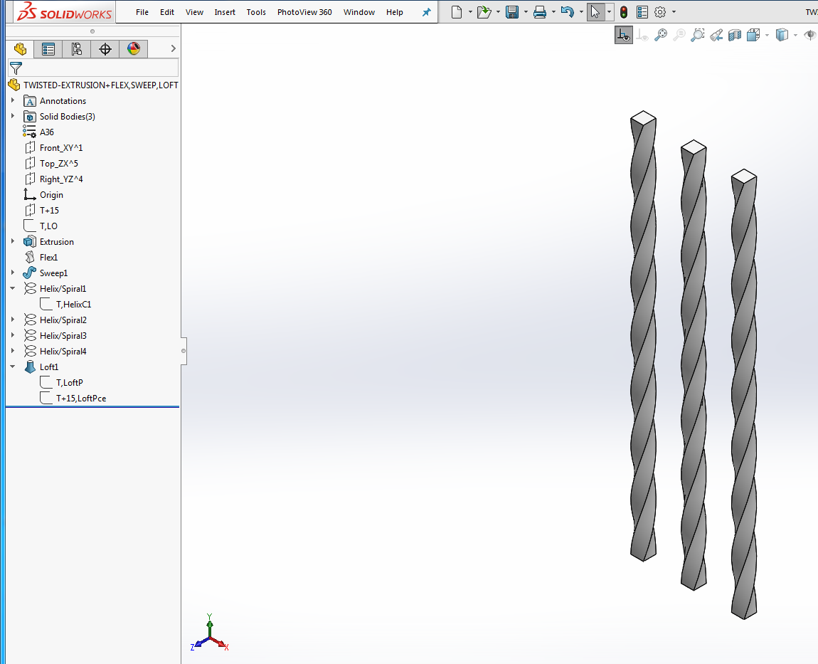

Twisted Bar modeled 3 ways - Extrude and flex, Sweep with twist, Loft with helical guide curves
Step 1: Finished Product Revealed
The three bars below were modeled using three separate methods: apply flex to extrusion, sweep with twist, and loft with helical guide curves.

There you have it - three methods to model a twisted extrusion.
