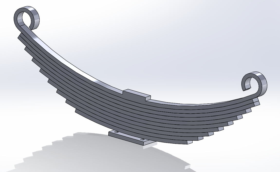

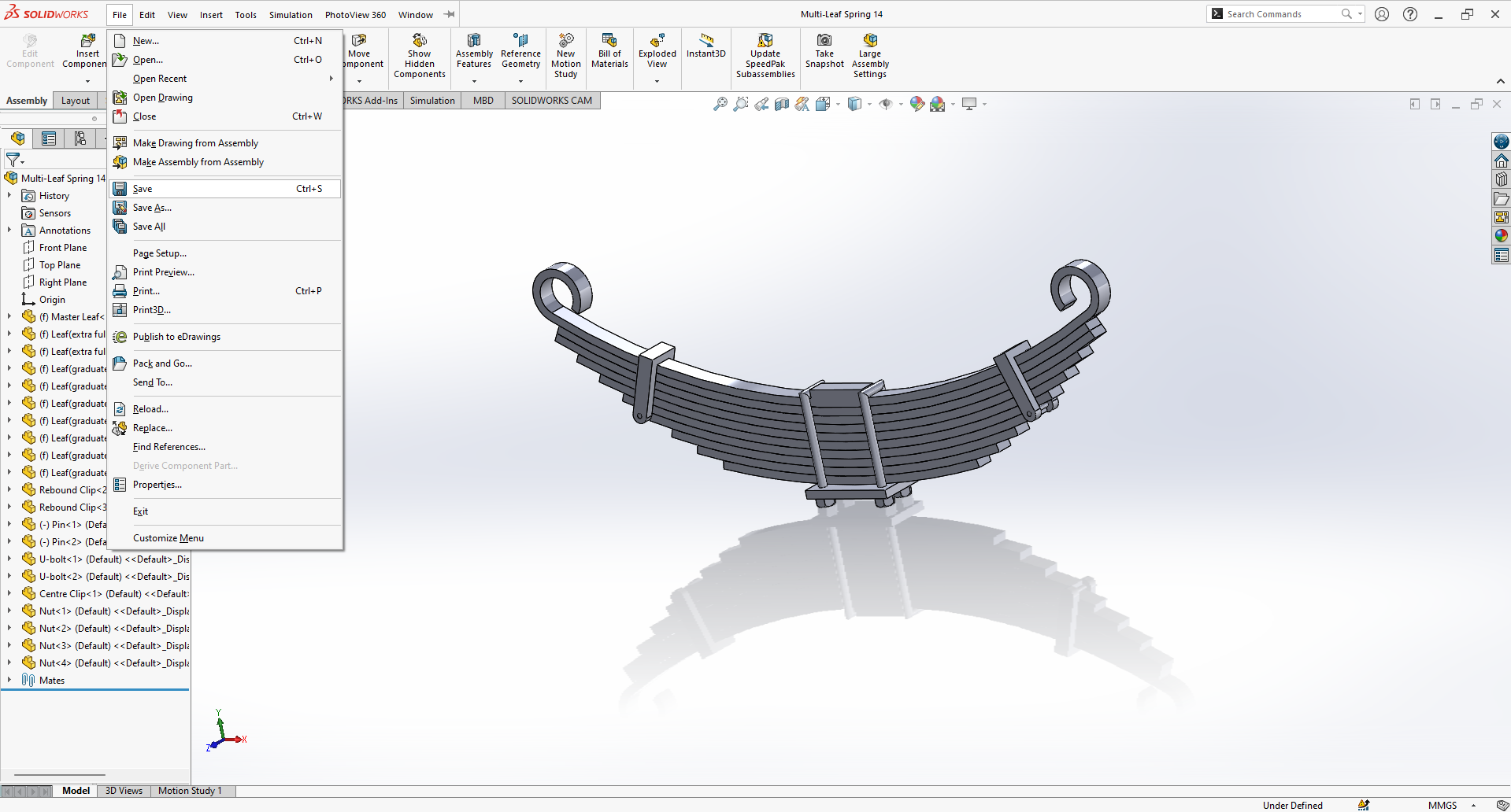

The Multi-Leaf Spring model is a robust and reliable suspension component designed to distribute load and absorb shocks in vehicles. Engineered with multiple layers of steel leaves, this spring provides enhanced strength and flexibility, making it ideal for heavy-duty applications. Designed using SolidWorks, it ensures durability and optimal performance in automotive suspension systems, particularly in trucks and off-road vehicles.

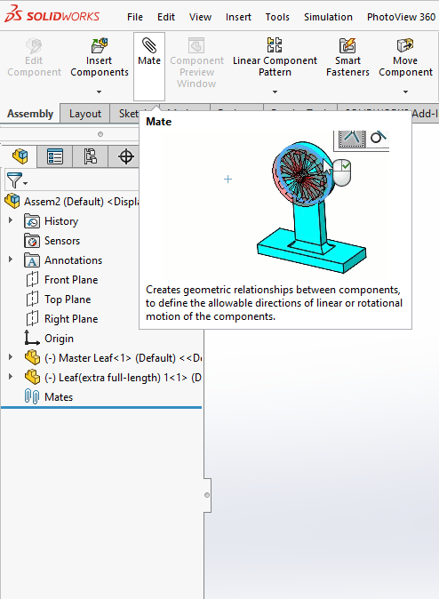

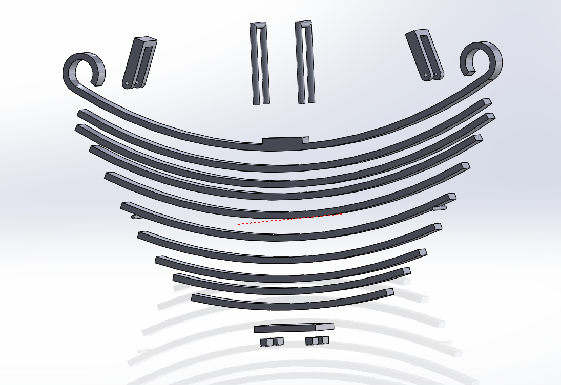

  2. Step 2: Insert the Parts into the Assembly
    1.Insert the Main Leaf (Master Leaf):
    • Go to Insert Components and select your main leaf part.
    • Place the main leaf into the assembly workspace.
    2.Insert Additional Leaves:
    • Repeat the same steps to insert the additional leaf parts into the assembly.
    3.Insert Other Components:
    • Insert any center bolts, clamps, or spacers as required.

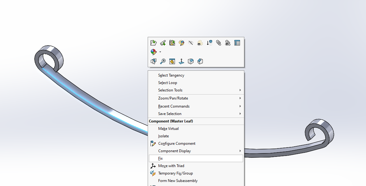

  3. Step 3: Position the Main Leaf
    1.Fix the Main Leaf:
    • Right-click on the main leaf component in the workspace and select Fix to lock it in place.

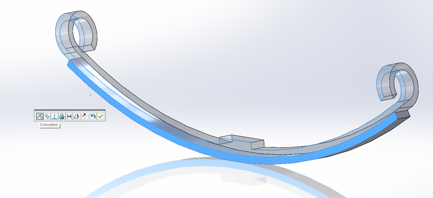

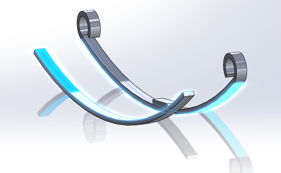

  4. Step 4: Align the Additional Leaves
    1.Mate the Leaves:
    • Use the Mate tool to align the additional leaves with the main leaf.
    • Start by selecting the top face of the bottom leaf and the face of the main leaf.
    • Apply a concentric Mate to ensure the leaves are touching.
    • Then Select same sides of two spring and apply coincident mate
    2.Center the Leaves:
    • Use a Symmetric Mate to center the leaves along the length of the assembly, ensuring they are evenly spaced.
    3.Repeat for All Leaves:
    • Continue adding mates for all additional leaves in the spring stack until all are properly aligned.

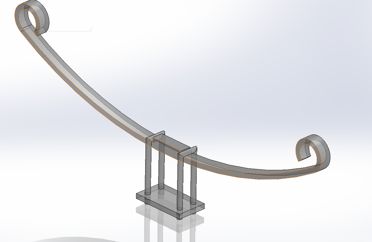

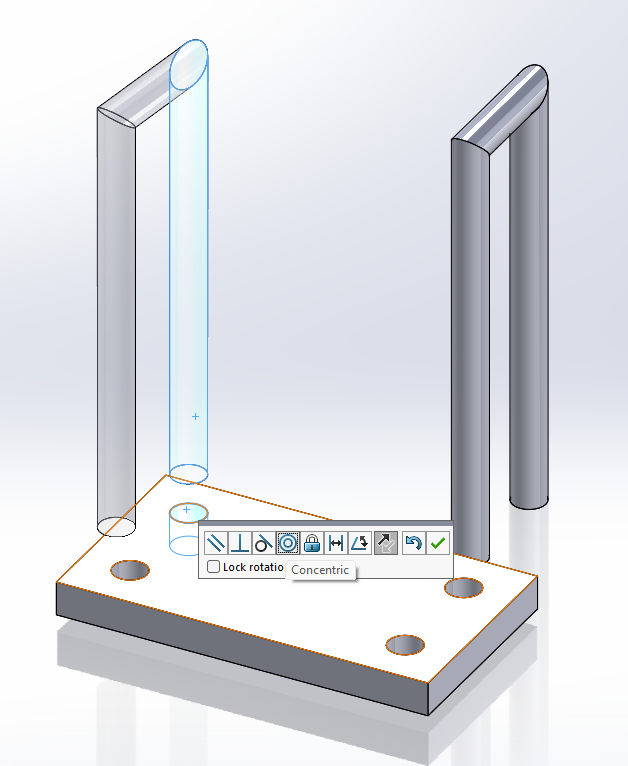

  5. Step 5: Add the Center Bolt
    1.Position the Bolt:
    • Insert the center bolt and use the Mate tool to align it with the center holes in all leaves.
    • Apply a Concentric Mate between the bolt's cylindrical face and the inner face of the leaf holes.
    2.Lock the Bolt:
    • Add a Coincident Mate between the head of the bolt and the top surface of the top leaf to lock it in place.

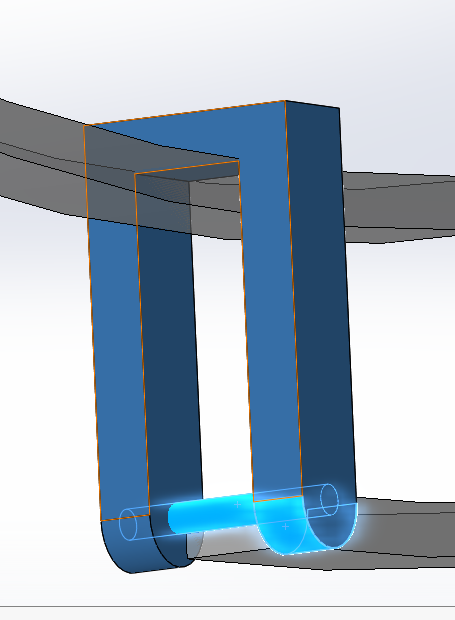

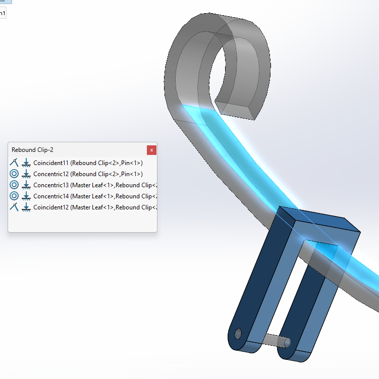

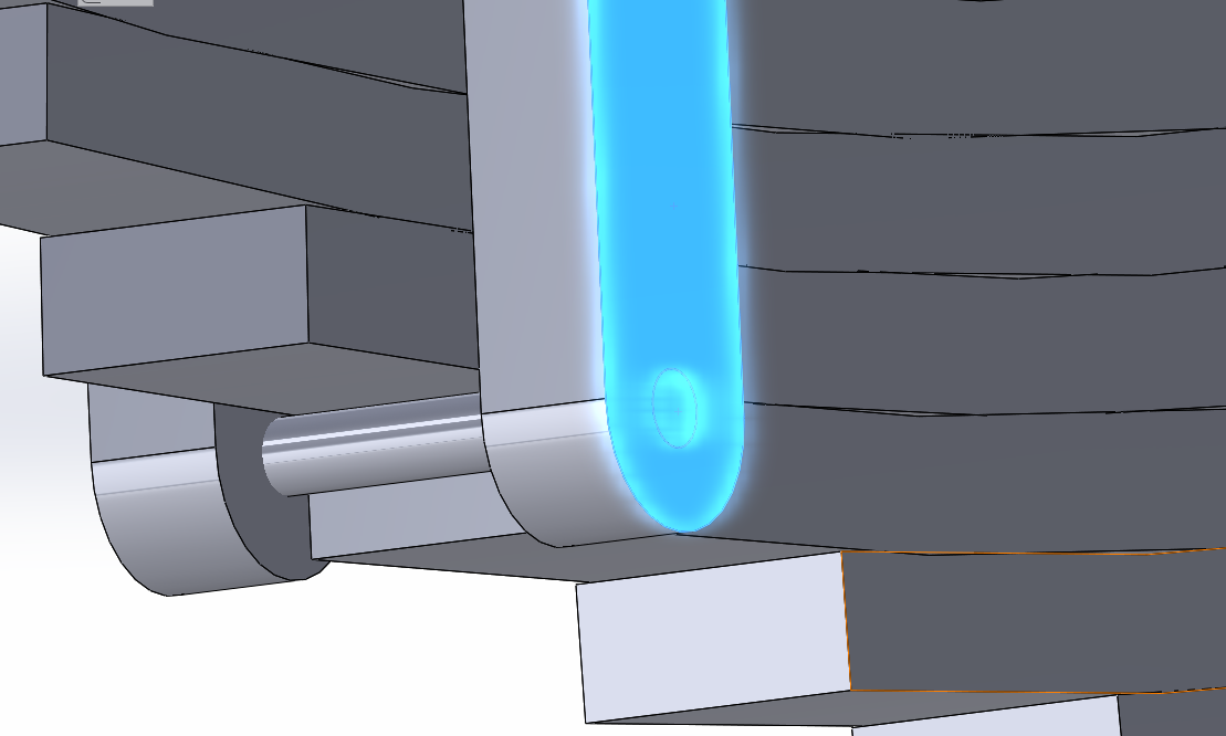

  6. Step 6: Add Clamps
    1.Position the Clamps:
    • Insert the clamps and use the Mate tool to position them on both sides of the leaf stack.
    • Mate the inner faces of the clamps with the corresponding faces of the leaves.
    • Do this on both sides
    2.Secure the Clamps:
    • Ensure the clamps are properly aligned and secure them with pins and appropriate mates (e.g., Coincident Mate).
    • Apply mate on inner side of clamp and outer surface of pin and apply concentric mate.
    • Finally apply coincident mate on one side of pin and same side of clamp to held pin in position.

  8. Step 8: Finalizing the Assembly
    1.Test Movement:
    • If your assembly requires movement (e.g., flexing), set up Motion Studies or apply forces to check how the assembly behaves.
    2.Save the Assembly:
    • Once satisfied with the assembly, save the file.

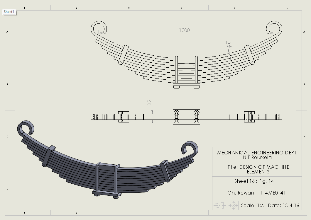

  9. Step 9: Create Drawings (Optional)
    1.Generate Drawing Views:
    • If needed, create detailed drawing views of the assembly for documentation or manufacturing purposes.
    2.Add Dimensions and Annotations:
    • Add necessary dimensions, notes, and annotations to the drawing.
