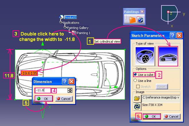

You will be taken in to Sketch Tracer work branch. Save it with a appropriate name. It is a Catproduct file.
  1. Step 1:
    In view toolbar select the top view..
  2. Step 2:
    After selecting Immersive sketch a file selection dialogue box will open. Select the top view from the reference image folder. If still you have not the reference images you can download it.
  3. Step 3:
    By default it will be in set cylindrical view mode. No need to change this.
  4. Step 4:
    In this step add other views same style.
  5. Step 5:
    Drag it to the back area by following step 11. Yes the reference imager are ready. Congratulation you have successfully set the reference images. If not then you can download it and Start your model. I encourage you to start a new one and send it to me.
