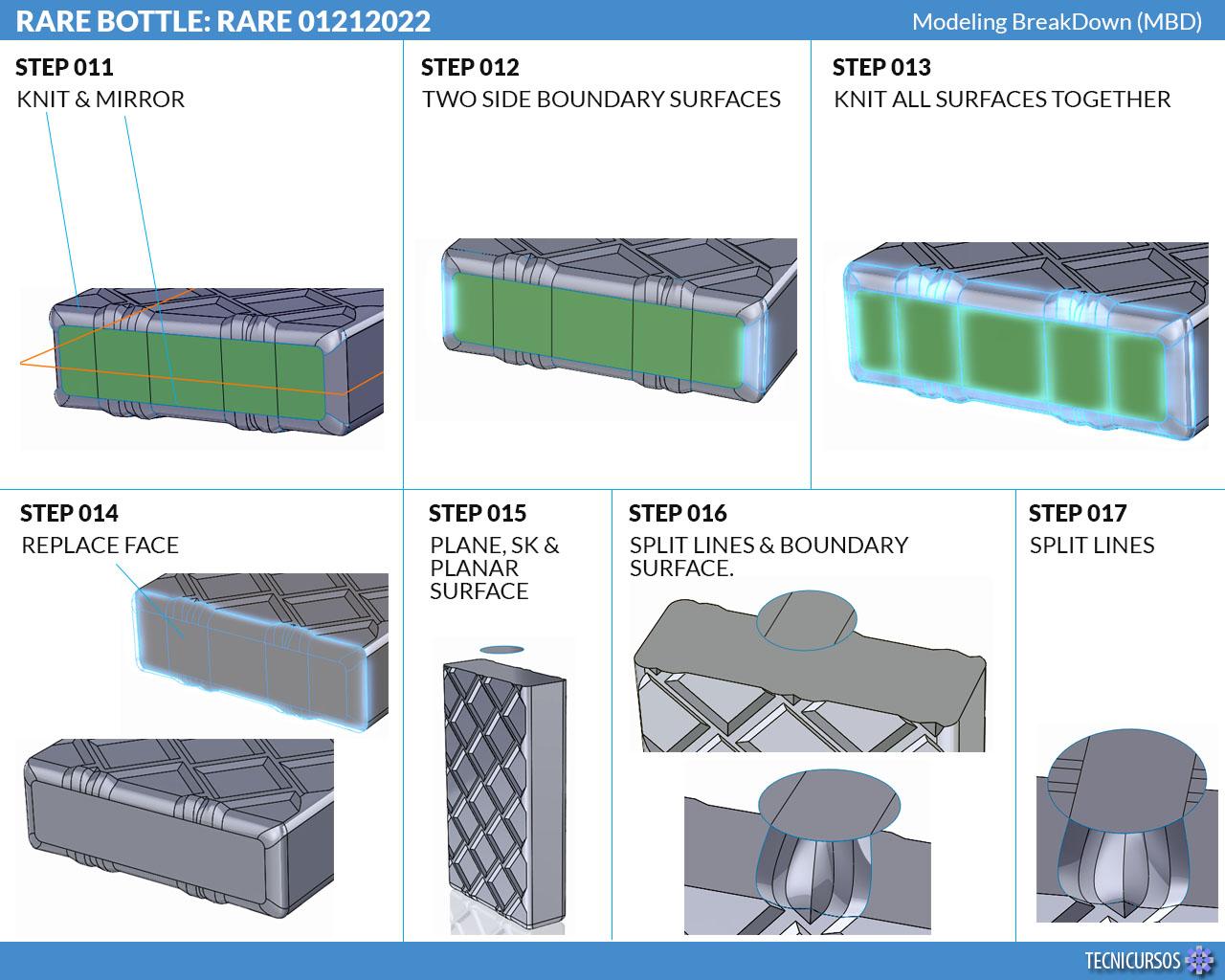

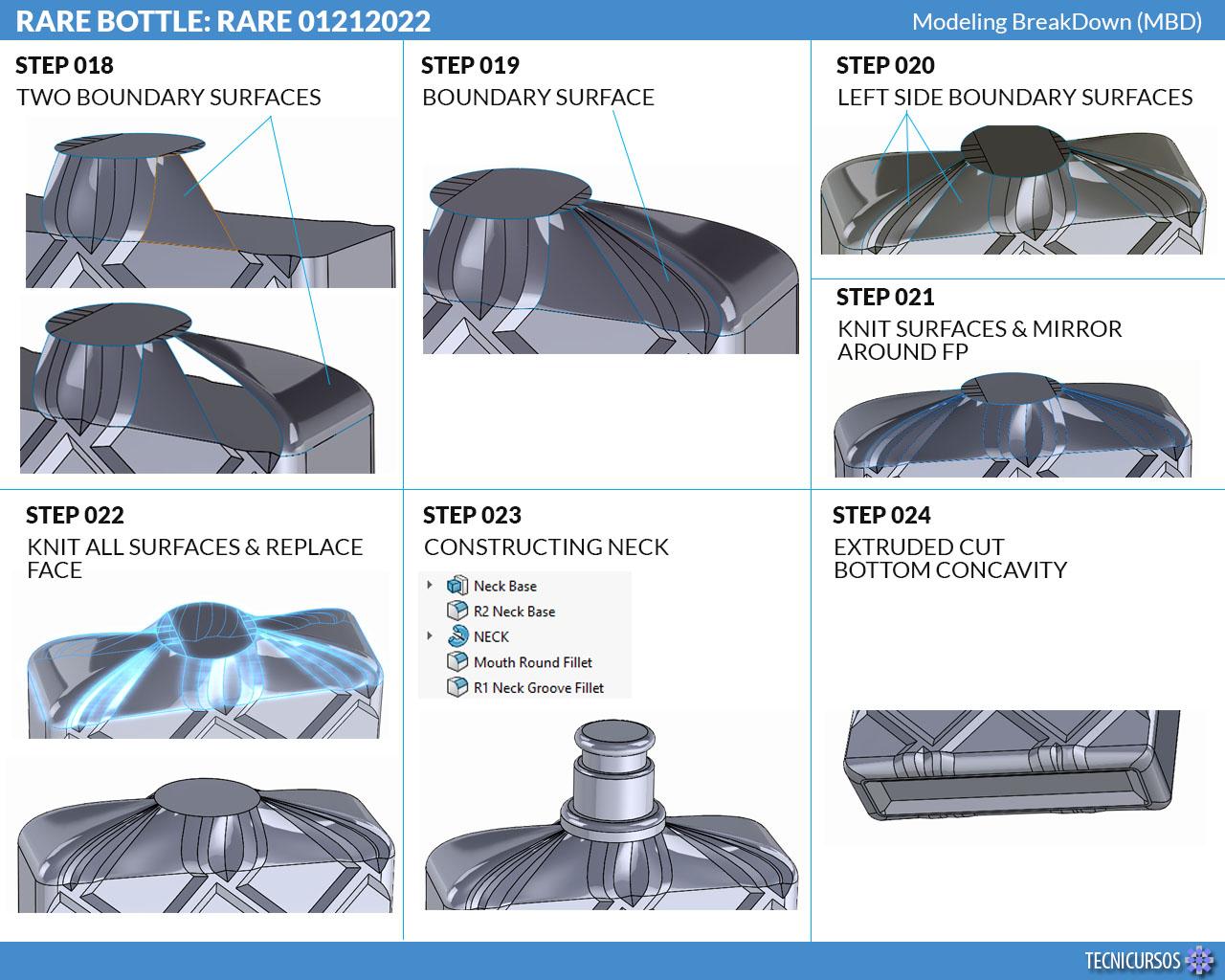

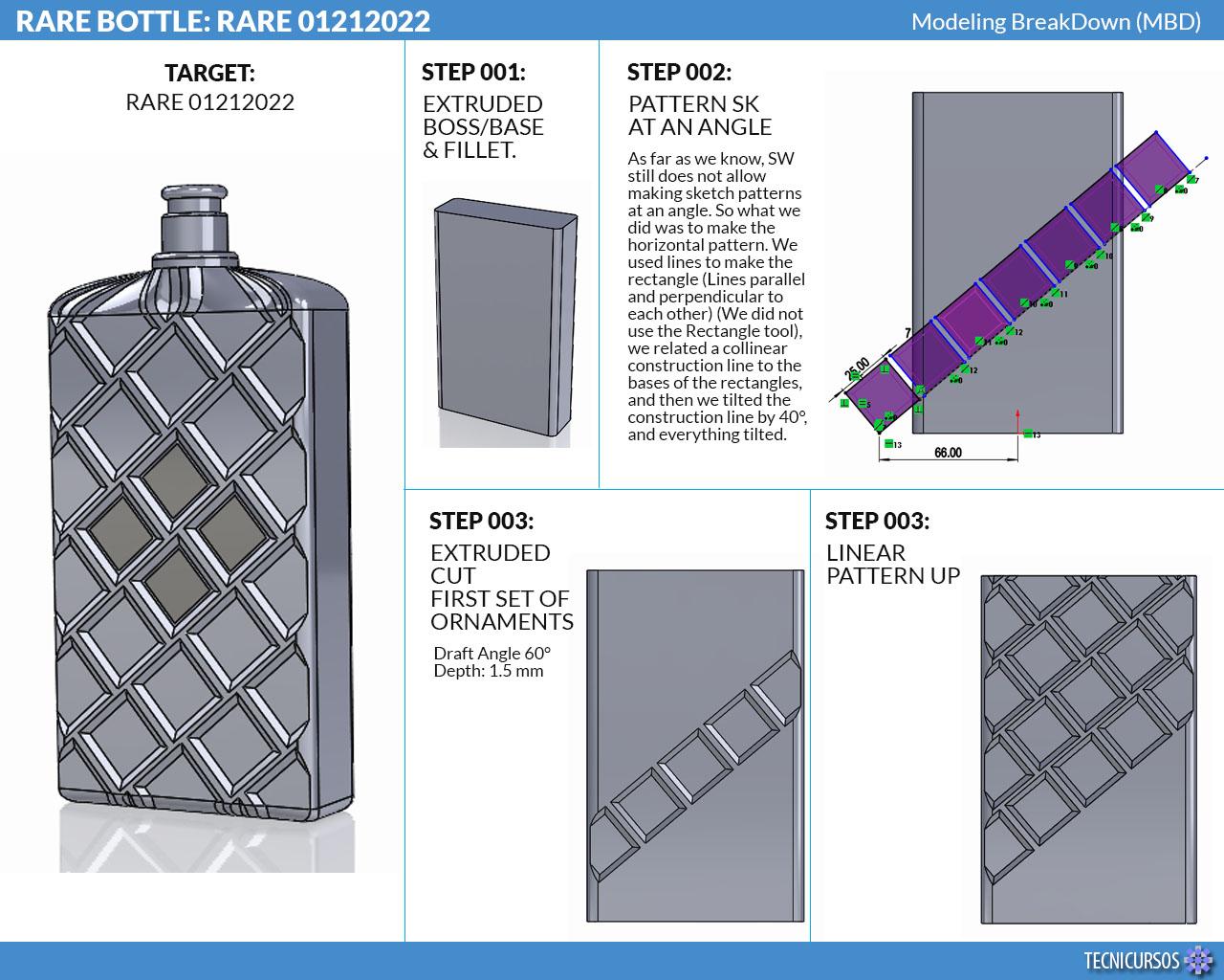

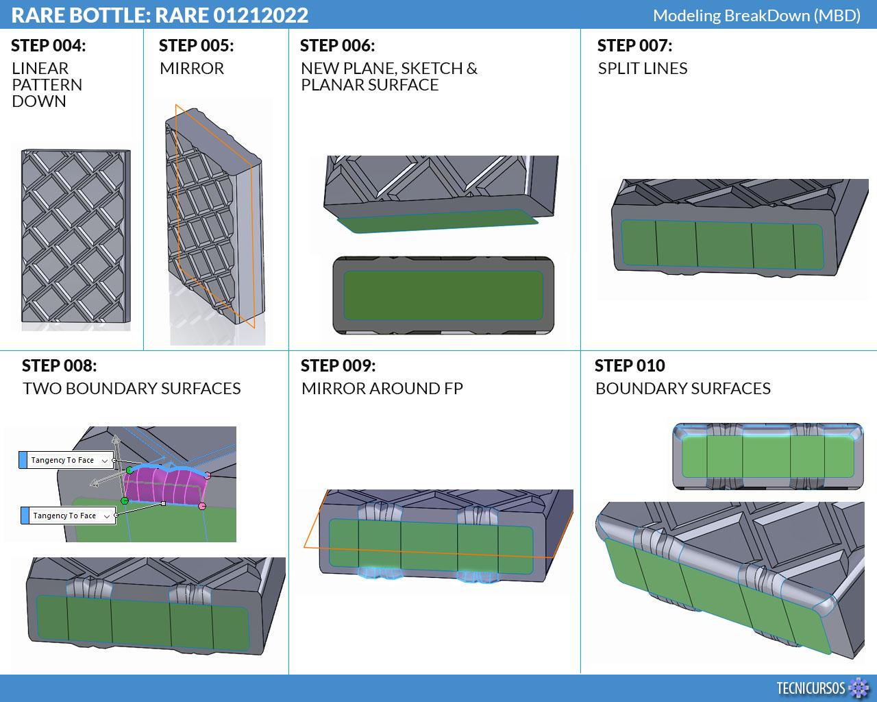

Modeling breakdown of our RARE bottle 01212022.
You will find several interesting modeling tricks and strategies. And how to face the bottom and shoulder of the bottle.

  1. Step 1: STEPS 1 to 3...
  2. Step 2: STEPS 4 TO 10...

  4. Step 4: STEPS 18 TO 24...
  5. Step 5: STEPS 25 TO 33. The End...
