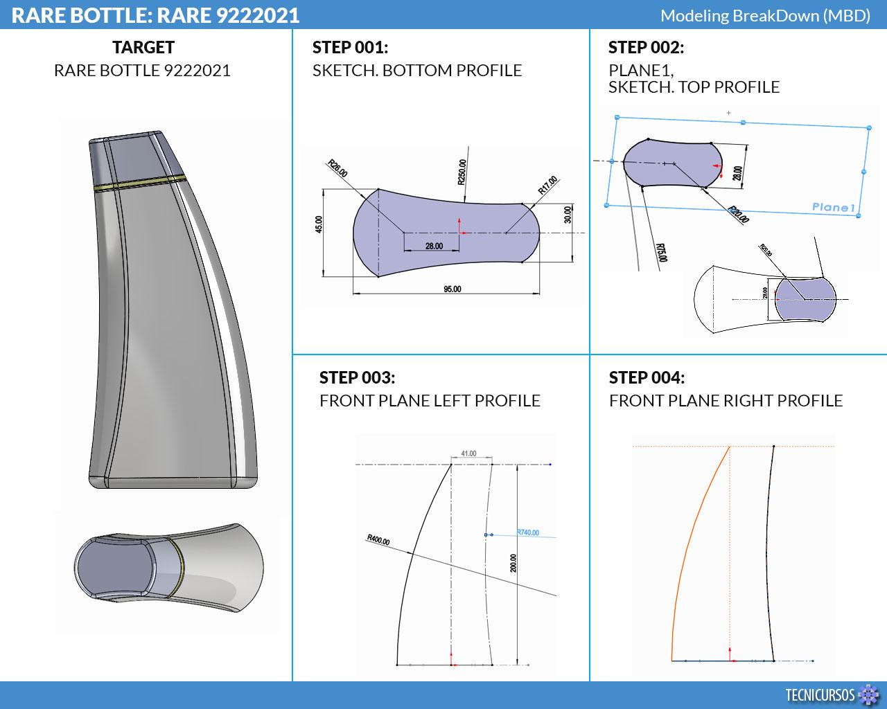

Modeling breakdown (MBD) of our 9222021 bottle from the "RARE" series.
The use of 3D Sketch for the guide curves in the Boundary Surface command is shown.
Step 1: Steps 1 to 4...

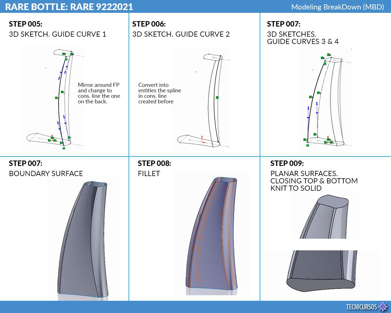

Step 2: Steps 5 to 9... (3D Sketches)
Step 3: Steps 10 to 15...

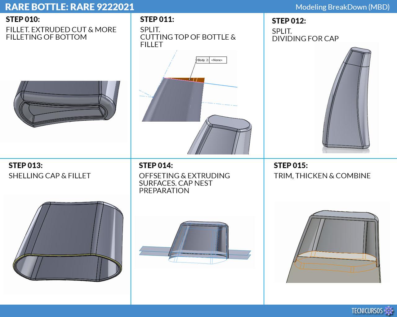

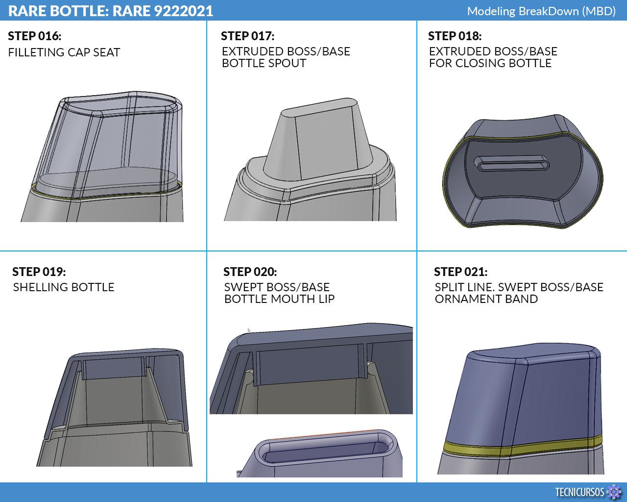

Step 4: Steps 16 to 21...
Step 5: The End...
