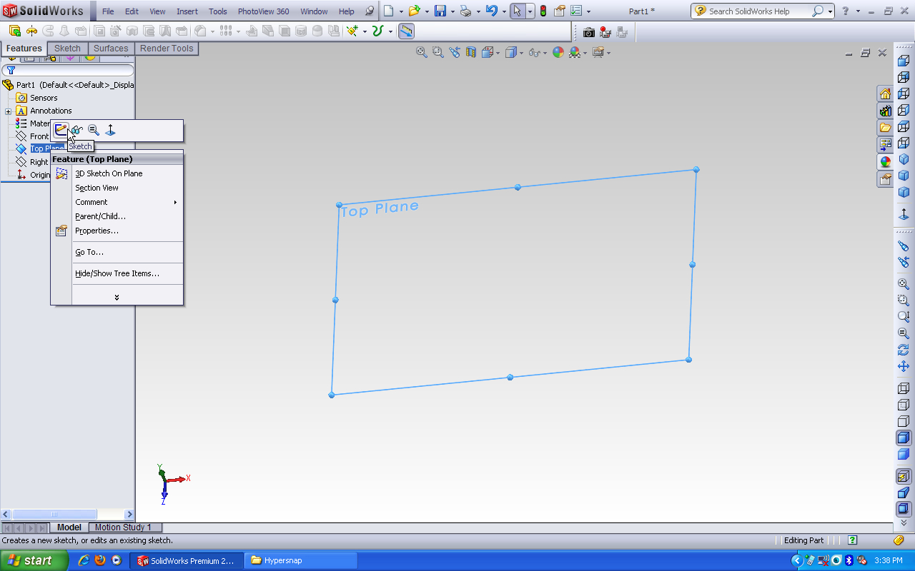

Step 2:
Invoke a sketch on top plane

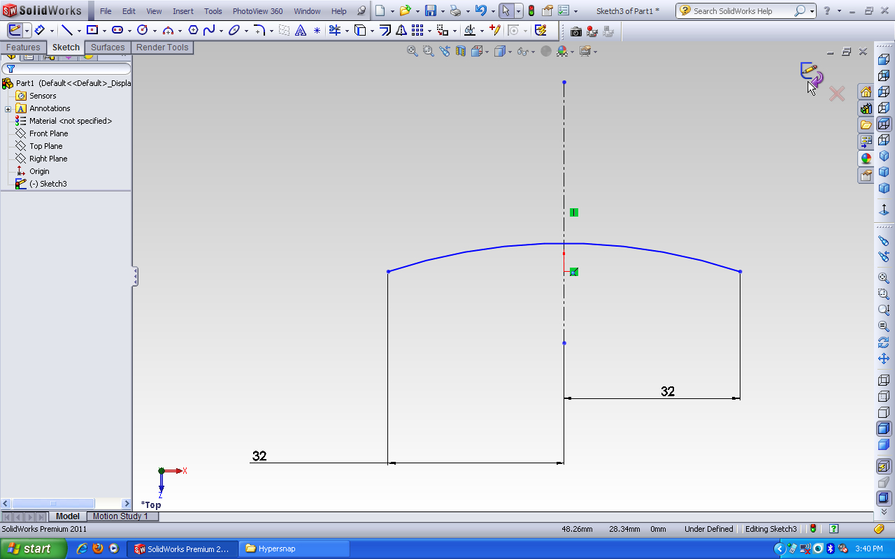

Step 3:
Make an arc as shown
Step 4:

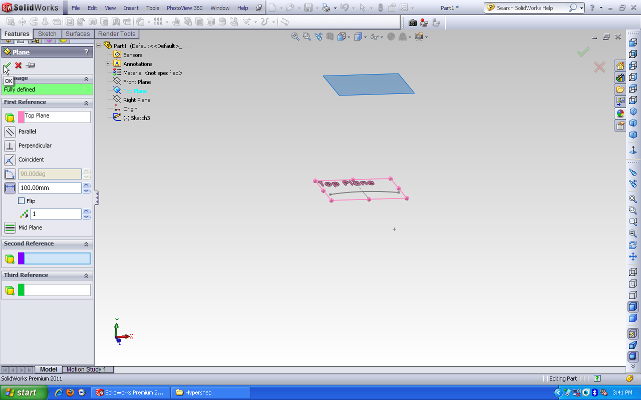

Create a new plane. Insert-> reference geometry-> new plane
Step 5:
Provide a dimension and click ok.
