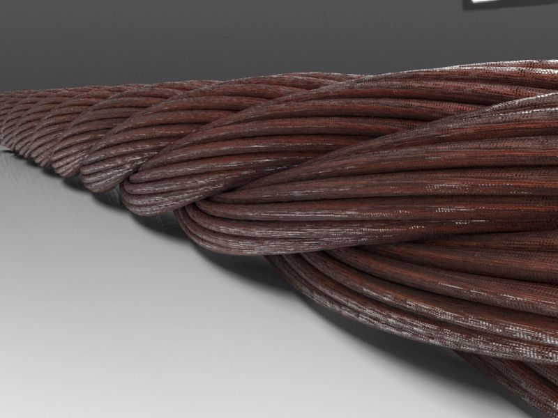

This is the part that will be modeled now. Rope 6X12/6/1 configuration.

  14. Step 14:
    14. This is the finished part.
  15. Step 15:
    Now you may render it with you favorite rendering software.
