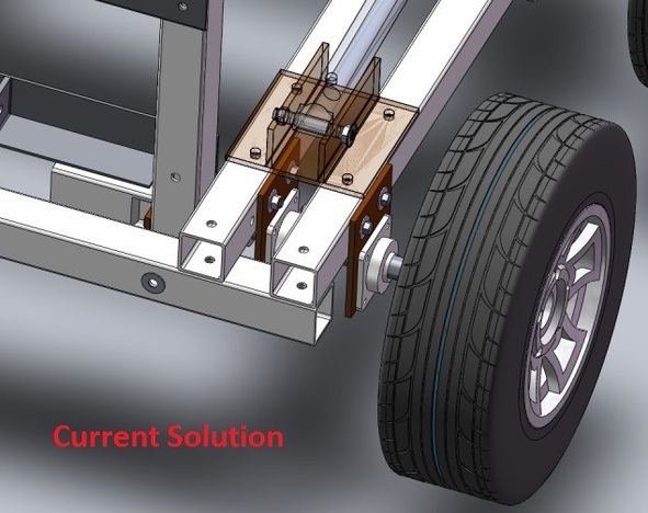

Current conception of the wheel assembly:
http://opensourceecology.org/wiki/LifeTrac_Wheel_Assembly_Video
During the testing period, motor coupler appeared to fail and stopped functioning.
http://www.youtube.com/watch?feature=player_embedded&v=i4GjoFQ3zsg
The winning design is expected to be a monolitic assembly with motor, bearings, and shaft – that can be taken right off the existing frame – by loosening a bolt and releasing a cam lock.
This simplifies the former mounting method, where 3 mounting plates were attached to individual frame members by using 6 bolts (see the picture).

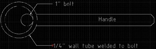

  • Bolt with cam around bolt, where cam is locked in by a lever and tightening the bolt both fixes the lever and pinches the frame tubing
  • Cam has a handle running parallel to the shaft when unlocked, and parallel to frame members when locked. Cam handle is welded directly to cam
  • A second bolt towards middle of assembly pinches the assembly around tubular frame members
  • A peg (see concept drawing) fixes the assembly in place on the frame. Note that the cam and bolt can be integrated into one, not shown on concept drawing. The second bolt is also not shown in the concept drawing
  • Cam concept (top view, bolt head not shown)

    For those interested in this challenge, we are looking for the simplest possible drive system for a skid-steering tractor which also allows for quick interchangeability of wheel units. This is simple in principle, yet most difficult in practice. There is no industry standard precedent. Considerations regarding the driving force itself, without considering the quick connect wheel mechanism – are:
    1. Prototype 1 (http://blog.opensourceecology.org/2008/09/lifetrac-continued/) of the tractor had 4 wheel drive and 32 cu in motors, with articulated steering. The wheel motors are coupled directly to the drive shaft for simplicity. Axial loads are negotiated via 4 double-split lock collars on each axle. Radial loads are negotiated with heavy duty bearings. This tractor has now been in operation 4 years. There is a slip clutch in effect protecting the wheel motors - wheels can simply spin out under excessive load. 16" truck tires have wheel chains here. Each side of the tractor is controlled by a spool valve, with motors on each side in parallel with each other.
    2. Prototypes II and III feature tracks. Because wheels and motors are connected by the tracks, the motors sometimes fight each other and prevent proper bypass of pressure spikes in aggressive driving.
    3. We have broken 2 motors already on Prototype II – the motor broke internally. In prototype III, we have broken shaft couplers and sheared the shaft key on 3 motors. It appears that the reason is that we ran the motors at too high pressure. We got the motors from SurplusCenter, and these were rated at 3050 psi in the catalogue, and now, the identical ones are rated at under 1200 PSI in the new catalogue. We ran them at 2500 PSI, so we may simply be running the motors over their rating and breaking them.
    4. At 1200 rated PSI, the above motors are insufficient to drive the tractor if the tractor uses tracks. They have 1370 pounds of pulling power (total for 4) at this rating. When using tracks, the tractor requires more force to move.
    What are possible solutions to the driving force consideration?
    1. Use stronger 14 splined motors (8700 in lb), same 2-bearing mounting of shaft, with tracks (to address spinout and provide extreme traction) – with bidirectional pressure reliefs (cushion valve) added to each motor to prevent motor failure if they fight each other.
    2. Use stronger splined motors (8700 in lb), same 2-bearing mounting of shaft, without tracks, but 50/50 flow divider (to address spinout).
    3. Same as 2 but use stronger motors adapted to 6 spline coupler, with (15750 in lb motors (total 4200 lb of pulling force, comparable pulling power to F250 pickup truck) – advantage being adaptability to existing spline shafts on wheel axles. See http://opensourceecology.org/wiki/Quick_Connect_Wheels#Pathway_5
