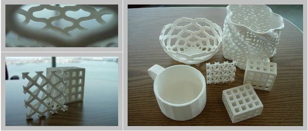

We are looking for designs for home décor products in ceramics. We will select multiple of winners with different designs instead of just a few.
The challenge: Design home décor ceramic pieces.
Where do you use ceramics? What type of products in ceramics would you like to see in the kitchen, for entertaining at dinner, in the bathroom or other rooms? How about the garden or the office? What would be cool to have completely customized? What would your friends like to see? Think home décor.
We create ceramics in designs that cannot be produced using conventional methods. We will keep this challenge as open as possible and want to see designer’s imagination and creativity.

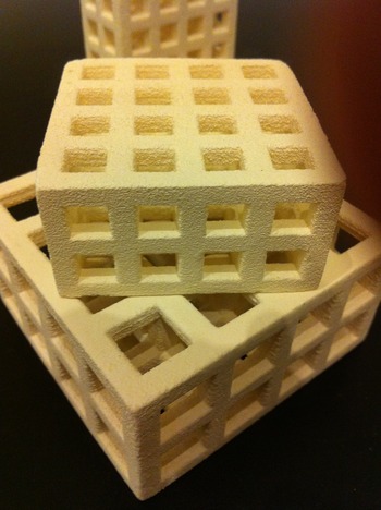

    Hi. I work for Figulo and have a few additional comments. First, an unsupported spiral cannot be easily printed. Even if it does print, firing the piece (think of your object turning into near molten rock) would cause its collapse. Also, ceramic materials are generally very brittle. A long thin span is very, very difficult.

    A couple of reminders. Our maximum bounding box sum is 400 mm. If you're designing an object between 301 mm and 400 mm in bounding box sum, the minimum wall thickness is 6 mm. Please keep the design rules in mind when creating your objects.

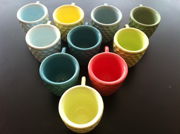

    Hello Forrest, can you tell us about the colors?
    I guess the white is the standard, you can use other colors?
    If yes, for the same object, only one color or multiple colors applied before glazing?
    Thanks for the answer.
    Flaviano Crespi has uploaded 360 CAD models & has left 1694 comments.
  • Forrest
    Forrest almost 14 years ago
    RE: Colors
    We're currently conducting colored glaze trials. We're exploring the full spectrum. Generally, we like to apply one color per object, but with a compelling design, multiple colors of glaze on a single object would be considered, certainly.
