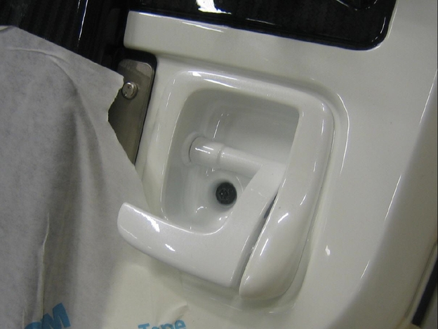

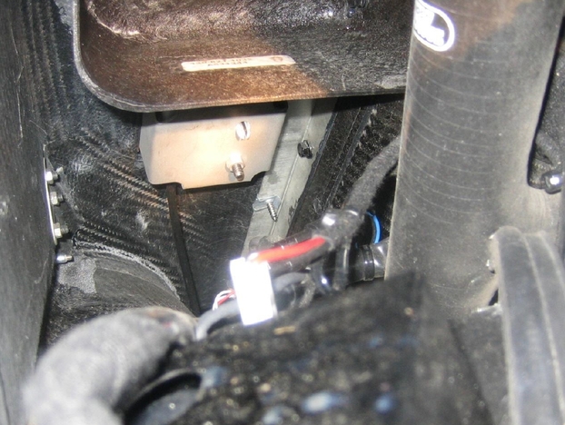

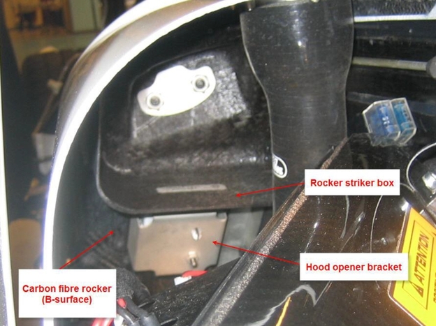

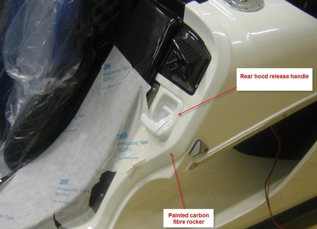

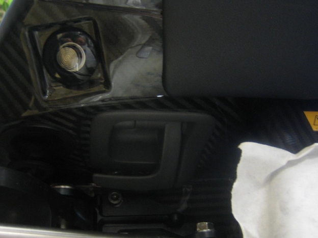

Koenigsegg hood release handle
Swedish super sportscar manufacturer Koenigsegg is redesigning their front and rear hood release handles and they have a challenge for you. Come up with something light, strong and beautiful and your solution might end up on one of the fastest cars on the planet.
They need a new, bespoke and lightweight solution to replace the standard one used at the moment. Current solution (front & rear) consists of a release handle and a back plate held together with one bolt and a plastic snap-fit. The back plate legs are fitted with rubber profiles to increase friction to rocker B-surface. New handle should be interchangeable with the current carry over component and should improve ergonomics and clearance to the door hinge. The new version can be a release handle assembly of any kind as long as the boundaries remain the same (rocker, door, dashboard carcass etc.).
Both front and rear handles mount to carbon fibre panels which can vary in thickness. You have to take this into account when designing new handles! The carbon fiber panel including paint and clearcoat have a final thickness of 3,5+/- 0.5mm. Also have in mind that carbon fiber B-sides are not tooled surfaces.
Requirements
  • Light weight design
  • Materials - aluminum or carbon fiber or both.
  • Ergonomic - lever should be easy to grab
  • Interchangeable with the current carry over lever (It doesn't have to look anything like the current part - it just cannot be bigger)
  • Improved clearance to the door hinge
  • Simple enough to manufacture
  • Simple enough to assemble
  • Current standard handle is spring loaded
  • Lever has to be able to pull the cable at least 20 mm
  • Lever should look like it belongs to a super car not a family saloon
  • Do not stare blind at that currently used standard release handle assembly and the back bracket (you might not even need a bracket > saves weight). Only use them for critical references
  • Please keep in mind the finger loads - the lever gearing should be similar or better (lighter) than the current handle solution.

    SWEEET. Is the rear hood release in that orientation to be operated while standing next to the vehicle?
