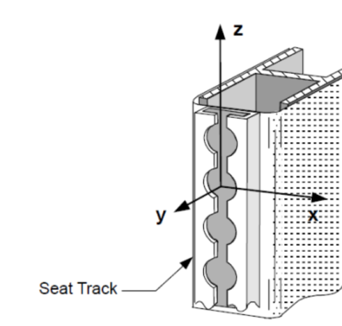

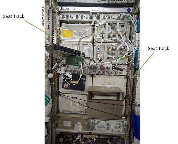

Seat Track Interface
The United States developed modules on ISS include payload racks that help maximize the space available and have standard interfaces. The racks have seat track that span along the front edge of the racks (see attached ISS rack photo) and the seat track is used to mount hardware. The seat track is metallic and has small features with high strength capability similar to those utilized on commercial airplanes. The interface to the seat track should be designed to the specification in MS33601, available by clicking "Download Specifications" below. Please note we understand the specification is outdated, but the NASA interfacing components meet this specification. For more information on the seat track, please refer to NASA’s previous GrabCAD Challenge.
Mounting Plate
The EAS will hold a NASA provided 0.25 inch thick mounting plate with the experiment. The EAS must provide a means of attaching to the NASA mounting plate. The available volume and keep out zones for the EAS are depicted in the attached drawing. Submissions should design the fastening system (captive fasteners, retaining pins, etc.) to the experiment plate in a way that optimizes the ease of assembly and installation.

  • André Ferreira
    André Ferreira almost 10 years ago
    @Goofy I think we are making the connection between the EAS Envelope and the 2 seat tracks, for a easy assembly on the ISS while in orbit. Please anyone correct me if I´m wrong.
    André Ferreira has uploaded 1 CAD models & has left 4 comments.
  • André Ferreira
    And develop a new optimized EAS

  • Marco
    Marco almost 10 years ago
    Only to become more clear:
    Screenshot comment
    Are suppose to design the connection between the seat track (blue) and the mounting plate (green) and this one must not pass the brown boundary?
    While the red solid is the payload.
    I am correct? Or there is something i missed?

  • Handily1
    Handily1 almost 10 years ago
    1. Is there s Standard CAD Model available of the Seat Track that matches the MS Std and the Mounting Envelope?
    2. There are mounting hole for attaching the tracks to framework shown on commercially available tracks.
    2a. Question: What is NASA's requirement for mounting the tracks?
    Handily1 has uploaded 1 CAD models & has left 20 comments.

  • Paul Berg
    Paul Berg almost 10 years ago
    I understand the details of the Seat Track and Stud that goes in the seat track. I am not sure if the studs lock into the track by design.
    Do we need to come up with a method to secure the studs of the EAS into the seat track.
    OR can we move forward knowing that the EAS is locked into seat track because it has the studs as described in the spec?

  • Michael Friday
    Michael Friday almost 10 years ago
    @Marco:
    The plate needs to remain flat. Yes, you may add thru holes, tapped holes etc, for bolting or other hardware needed to attach to the plate. Whatever hardware you plan to use will be part of your EAS. You may install through the top side.
    Michael Friday has uploaded 0 CAD models & has left 44 comments.
  • Michael Friday
    @Handily1:
    The tracks are already installed. Is your question about mounting the EAS to the tracks?
    The envelope shown in the EAS drawing is correct, the extra length of track shown in the drawings is for reference only. Other hardware is attached in those locations and limits us to the envelope shown.

  • Paul Berg
    How are the studs secured to the seat track?
    Paul Berg has uploaded 8 CAD models & has left 13 comments.
  • Dan Rudmin
    Dan Rudmin almost 10 years ago
    I'm pretty sure the studs are not part of the seat track. You should include that feature or some equivalent into your EAS design
    Dan Rudmin has uploaded 4 CAD models & has left 51 comments.
  • Marco
    I believe we are suppose to design the stud, here is why:
    If the stud design wasn't necessary, wouldn't be a reason to give the design and the resistance of the seat track used in the ISS.
    Also, the the the first requirement:
    "Shall be capable of providing a rigid connection to the seat track "
    Say we need provide these rigid connection.
    Marco has uploaded 11 CAD models & has left 51 comments.

    1) Attachment method to mounting plate
    -Can we access and install fasteners from the top of it? (Z in the track coordinate system)
    -If yes, how high in Z are we allow to intrude and how big? do we need to have these bolts attached to a cable (captive) or can they be free?
    -If no, can we assume the fasteners can be installed from the bottom in any free space? Can the tread of the bolt exceed the top of the plate? If yes, how much?
    (by the way, if only top access is allowed but we can't go over the .025" thickness, the only option left is countersunk screws which in turn are going to be non-captive!)
    -Can we add a hole with Helicoil in the plate?
    -Are we allowed to modify the bottom of the plate (with I understand is flat)? If yes, by how much (X,Y,Z)?
    -Is the 1.0" bellow the bottom of the plate (experiment contour) still a "stay away zone"?
    2) Seat track attachments
    -The moment limits are going to be huge! the experiment 125lbs load is quite "tall" (Z) and away. Are you going to enforce this(I guess so)? but the calculations needed (360 deg around) are mind blowing. If we don't provide FEA, are you going to do the calculations for every entry? (can you simplify this rule? like in every 45 deg?)
    3) Shall have a deflection of 0.5"
    -All the entries are going to be some kind of mechanim-kind. How are you going to calculate this?

    Allan.
    I don't know what is right answer of your question. But i give a way how i did it.
    I make pillar of about 4 inch from mounting plate. I make this in same part than plate because its simplifies how FEA calculates. This pillar is 20 inch tall and its top is small 1/4 inch cube where forces are easy to put in right directions. Cube needs to be just as big that force is not making biggest yield in there. In bottom of pillar is big 2 inch fillet so 1/4 inch plate is not forced too much in tomb corners.
    I made seat tracks from 6061-T6. I think any material is possible because we need to show that forces are not over given table. And because outside dimensions are not given I only stay inside and top of track.
    Good luck to all who scratch their head in this puzzle! And remember the main goals: weight and simplify in assembly. ;)

    @Javier. Good questions.
    -Can we access and install fasteners from the top of it? (Y in the track coordinate system)
    Yes, you can install fasteners from the top.
    -If yes, how high in Y are we allow to intrude and how big? do we need to have these bolts attached to a cable (captive) or can they be free?
    We didn't specify a height limit but we don't expect the fasteners to protrude several inches into the free space. If they do, we would like to understand why you chose those fasteners. Yes, the fasteners should be captive.
    The fasteners can be installed from the bottom but it will be harder for crew access (refer to the crew access location in the EAS envelope drawing). We didn't limit you to 0.25" (I think you meant 0.25 instead of 0.025) inches. That was just the thickness of the plate.
    Yes
    What do you mean by modify?
    Yes but only 1" below the keepout zones of the plate.
    Yes, this is a criteria so it will be enforced. Let me get back to you after I talk with our stress and design engineers about the best way to clear up that requirement.
    -All the entries are going to be some kind of mechanim-kind. How are you going to calculate this? Please clarify this question. Are you asking how NASA is judging this criteria?
