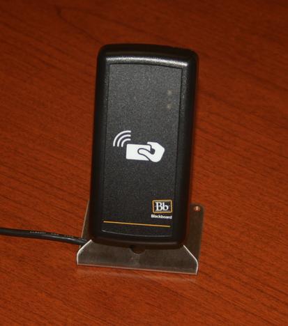

The picture shown at the top of the Challenge is one of our existing products, the PS4101-USB. The challenge device is an entirely new product that works similar to that one but will be mobile, not tethered by a USB cable.

    can you clarify what you mean by build dimensions? Is that the outer dimensions of the case? If so, it seems way off from the picture shown which has the height approx twice the width.
    Michael Herbert has uploaded 83 CAD models & has left 132 comments.
  • Chris Challinor
    Chris Challinor over 11 years ago
    The build dimensions listed are just a reference to the approximate size all the components would take up when loosely assembled in a manner that could work with a "box type design".
