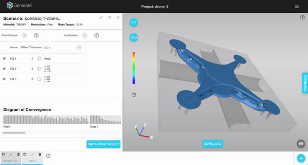

3. Set up load conditions, etc. in Generate and use it to create your final optimized model.
4. Download your optimized STL model from Generate and upload it to your GrabCAD entry (enter by clicking the "Submit an entry" button on the right side of this page).

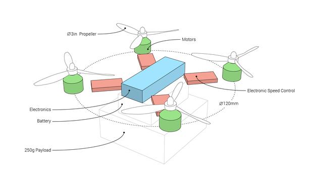

    1. Must hold electronics, electronic speed controllers, motors, battery and payload in positions detailed in CAD file here: Quadcopter Design Files (with one exception - the distance between the battery and electronics is not defined and can be altered by you, the designer)
    2. Max. mass of frame: 90 grams
    3. Attachment mechanism of all components to the frame will be using adhesive-backed Velcro in order to easily swap components during testing. While there are no requirements for minimum surface area for this attachment, this is something to consider in your design.

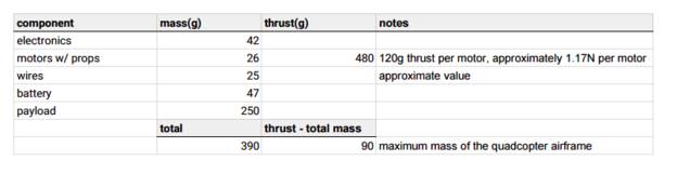

  • Zachary Rambo
    Zachary Rambo almost 9 years ago
    I'm with Hans Kristian Bruun on his questions, but would also like to add my own and point out a severe concern.
    First my MAJOR concern;
    If the motors produced 480 grams of thrust collectively, and the total AUW (including payload) is 480g, how on earth is this thing going to actually take off with that payload? T/W is 1:1 therefore it can not accelerate, take-off, or barely hover. Without the payload, the T/W is 480/230 (~2:1) not the best for a multi-copter. the T/W should be at least 2:1 when fully loaded, not empty. I typically prefer at least a T/W of 3:1 or 4:1 for appropriate control authority.
    Now my question;
    Do the masses listed take into account 4x of the appropriate pieces? I.E. the Motors are stated to be 26g. That is 6.5g per motor correct?
    Zachary Rambo has uploaded 0 CAD models & has left 2 comments.
  • Joseph Corsi
    Joseph Corsi almost 9 years ago
    Zachary, yes the listed mass of 26g is for all 4 motors with props. The listed maximum mass for the airframe is 90g. If the airframe had a mass of 90g, the quad will not take off, therefore the airframe will need to be less than this amount. We aren't looking for a highly maneuverable quad. The quad simply needs to lift and carry the payload the specified distance.

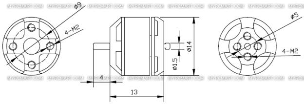

  • Zachary Rambo
    @Joseph Corsi,
    I have to ask you to reconsider your Motor/Prop combo or reduce your payload requirement. Even if the airframe were to be massless, the AUW (with payload) is 390g. That is a T/W of 1.25:1. That means the submitted designs will have a T/W of 1.00:1 to 1.25:1 when carrying the payload. T/W (w/o payload) will be 2.08 to 3.43. That is acceptable to achieve proper control and flight.
    With the payload, the motors won't be able to be effective enough to actually maneuver the quad. It is going to be a bear to fly, if at all. You need overhead thrust (Thrust on top of that required to hover) to perform basic maneuvers such as banking, flying forward, and turning. I can provide a diagram of the resolved force vectors to further my case if needed. With the highest T/W (with the payload), you'll have below marginal recovery time if something disturbs the quad. I can't stress enough trying to achieve a minimal T/W of 2:1 when calculated with a massless airframe and fully loaded with the payload.
    I would suggest using the RCX H1105 *V2* 5000KV from myrcmart.com (same size, shape, and vendor as one listed in challenge) with the 3x2 prop and a 4s battery. That will yield 198g thrust each for ~790g thrust total. Just use an appropriate 10A ESC. The T/W is still below 2:1 (1.65:1 to 1.98:1), but it is better than 1:1 to 1.25:1.
