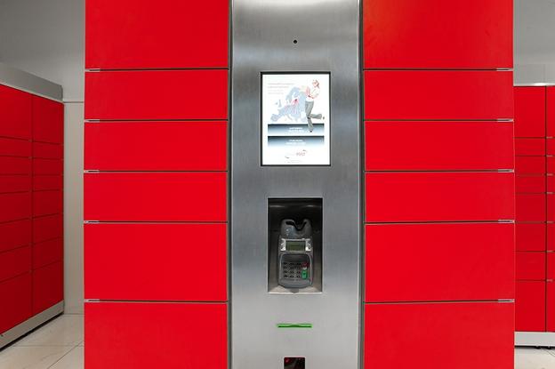

The mission of Cleveron is to make sending and reception of parcels as fast, convenient and cost effective as possible by offering the modern technology based solutions.
