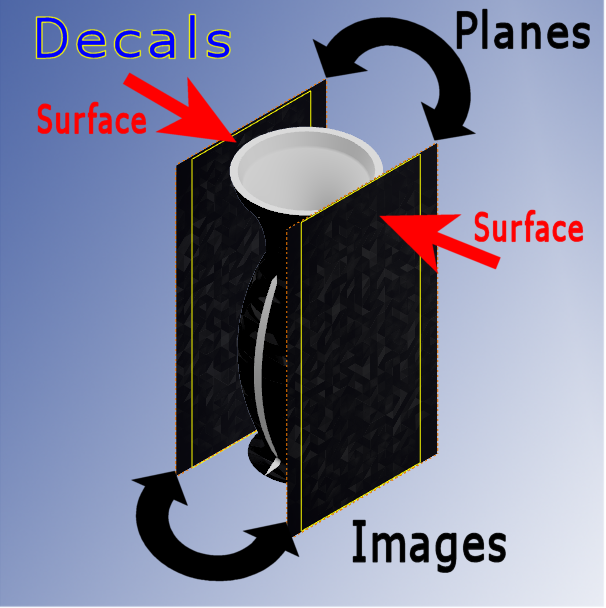

OK first of all you made your Vase far to complicated.
Secondly your image was on the centre plane to use it as a decal you have to put planes on the right and left side of your model then new sketch with image then decal both to nearest surface.
Decal rarely covers 100% of the model its better to use your image as a texture
