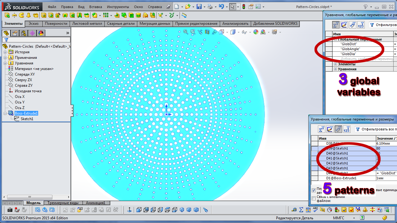

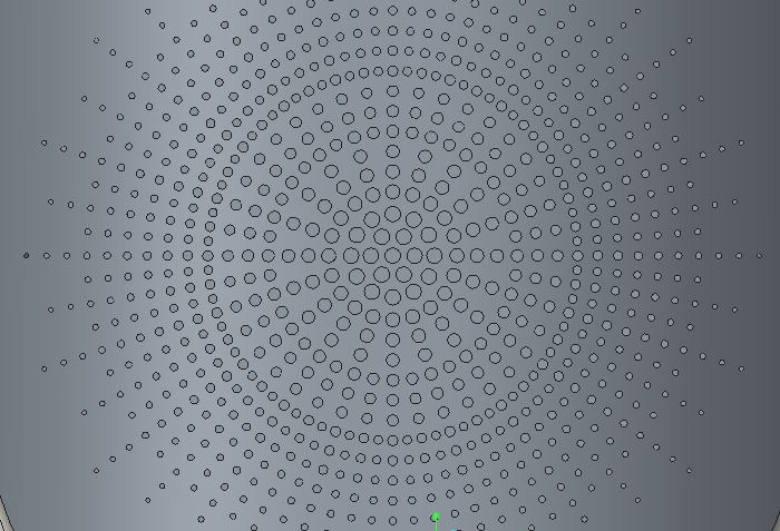

Any idea how to make such patterns in solidworks?
I wish to make this pattern (image attached) without going through the painful process of doing the circles manually. Is there any easy way to do it?
7 Answer
You guys really think I don't know that SW has a circular pattern option? :-P
If you see the image there is a variety of holes , different scales and having different no of holes. If I keep making all manually there will be a plenty of features on the feature tree. Instead I wanted a single or double options to reduce the manual work.

Each of the next hole from the center to the edge is reduced in size
https://d2t1xqejof9utc.cloudfront.net/pictures/files/72099/original.png
Used three linear patterns and 2 circular patterns. But want a simpler way to do such things and not using equations.
Answered with a tutorial: https://grabcad.com/tutorials/any-idea-how-to-make-such-patterns-in-solidworks
you pretty much need a circular pattern and some equuations to change size, any idea i can think of pretty much requires a pattern....

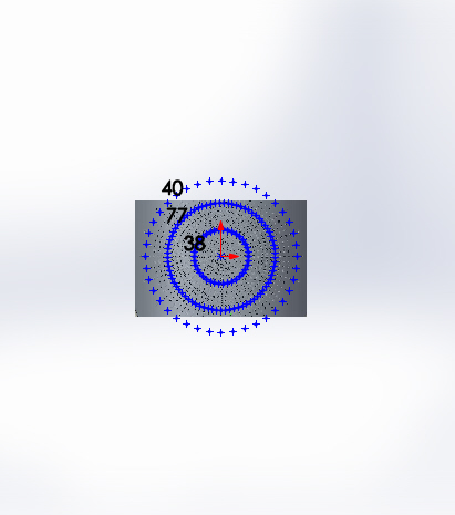

the fastest way is to use circular sketch pattern
insert image in part,put origin in the middle of image
sketch one circle of circle line and use,as I said,circural pattern,so
you can get all circles in circle line...
iI bealive this is a fastest way...
