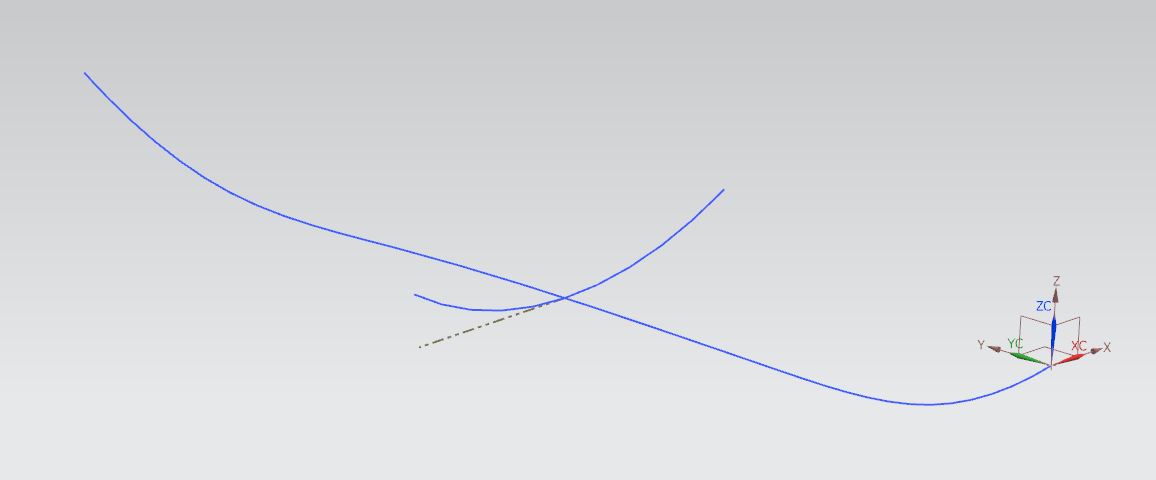

First off, you'll need a spline that defines the profile down the centerline of the board's length. (see "centerline_top_profile")
Then you'll need a sketch that defines the curvature at the center of (perpendicular to) the spline you just made. (see "midpoint_curvature")

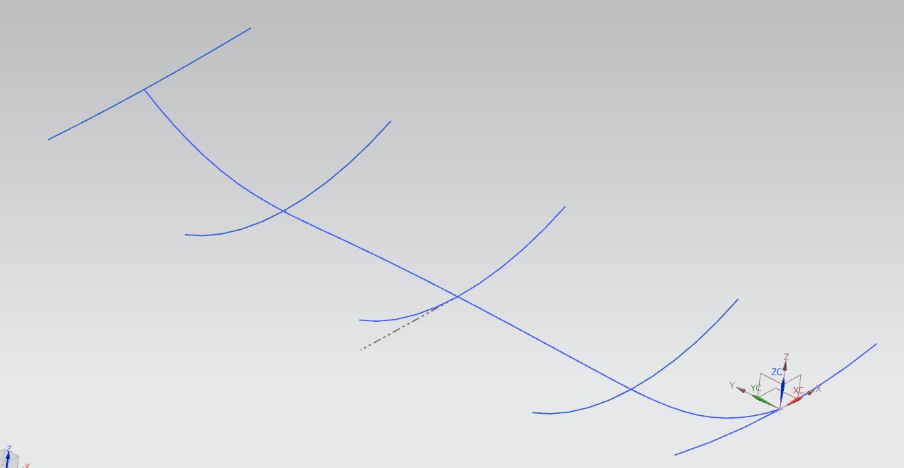

Then you'll need other primary curves along the 1st spline that define the rate of change in shape. (see "curvature sections")

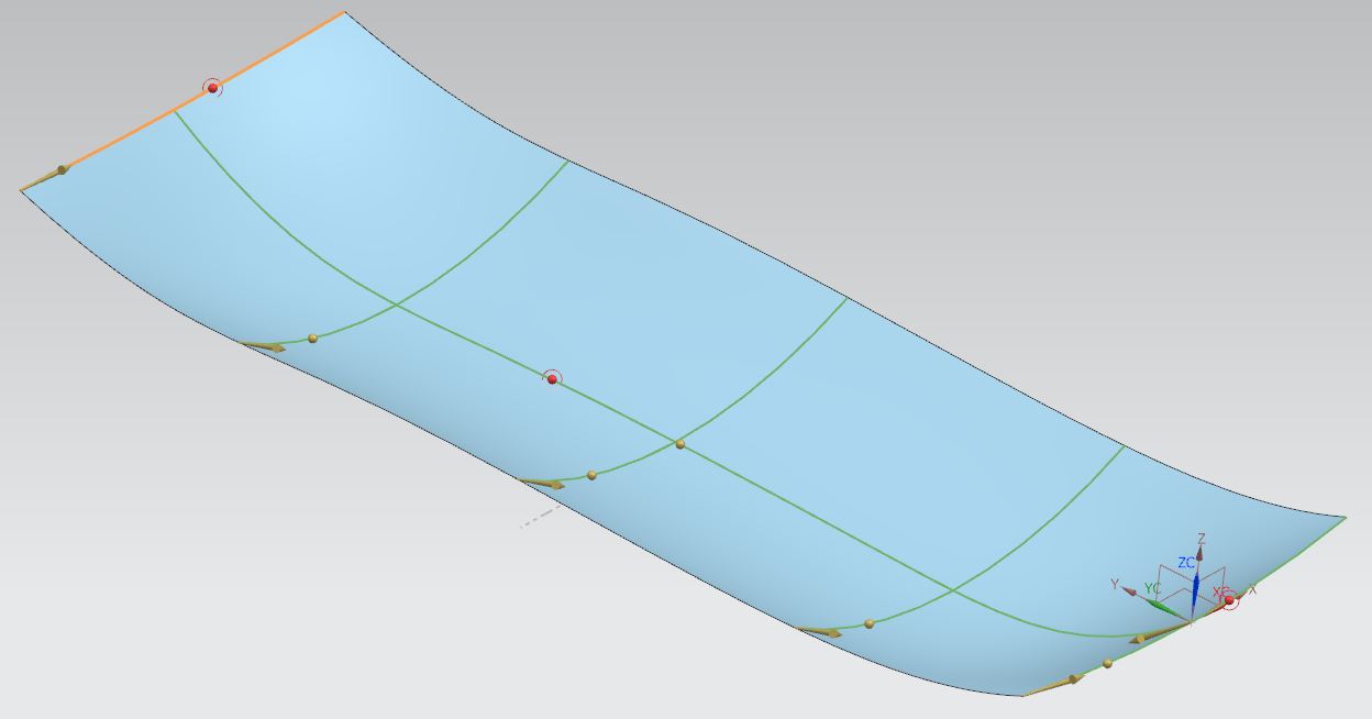

Once you have all of those built, you simply drive a surface through all the sections using the 1st spline as your guide. (see "surface_creation")
This exact technique will differ dependent on the CAD system, but is pretty universal.
