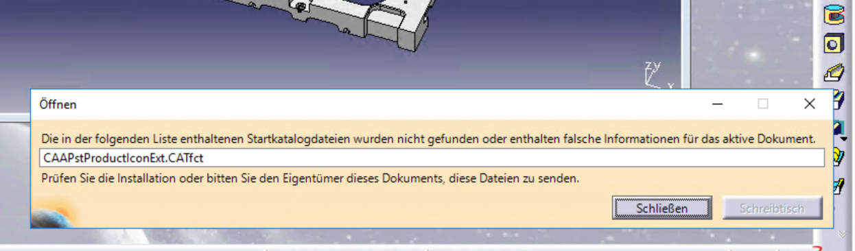

.CATfct error
When I open one of my assembly in Catia I receive an popup showing that .CATfct file is missing.How to fix this.
Based on the name of the file in the error message, the missing file is something that has been customized and added to the author's CATIA system. Contact whomever you got the assembly from and ask them to send you this file.
You might also try the DESK command to find and open this file.
You might be able to fix the problem by cleaning the file with the CATDUA utility program. (but be aware this might delete whatever is causing the problem, so you part might be different after cleaning)
