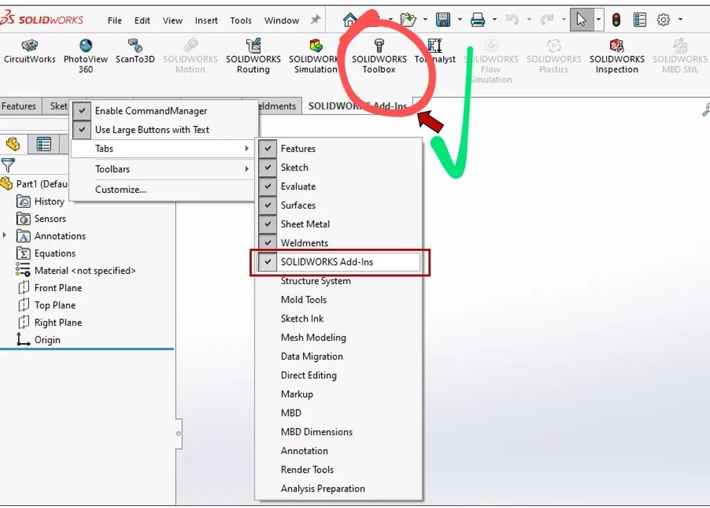

Hi Tony, you can try the below as an alternative to drag-n-drop.
Since you havent specified if this happens in an assembly or in a part, im going to assume you did this in assembly mode.
Create a new part (not assembly), when open go to the Solidworks Add-Ins tab and enable Solidworks Toolbox. A new button will appear to the right. Look for the "I-beam" icon and tap on that.
Choose your steel member and click create.
It should make a 2d sketch allowing you to edit dimensions and further to create a solid body extrude or sweep of the 2d sketch.
Hope this helps.
