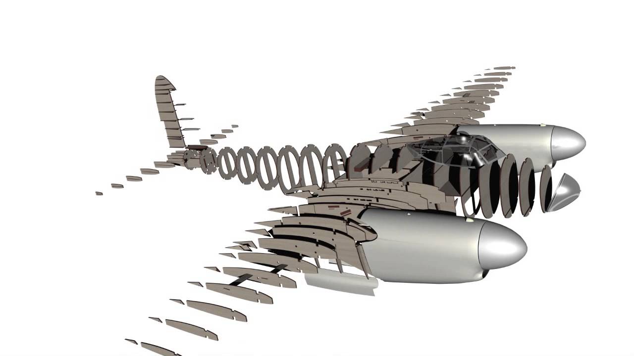

So I have a shot of an abject from the side and slightly from above. Is there some trick to converting it into a 2D image that I'm not aware of? The other problem is the fact that I think my projection is perspective, i.e. it's like a camera would take a shot, not the way CAD programs work. So everything gets smaller the further away you get form the camera.
Specifically, I'm talking about a profile. In other words, I have a picture of a profile of an object.

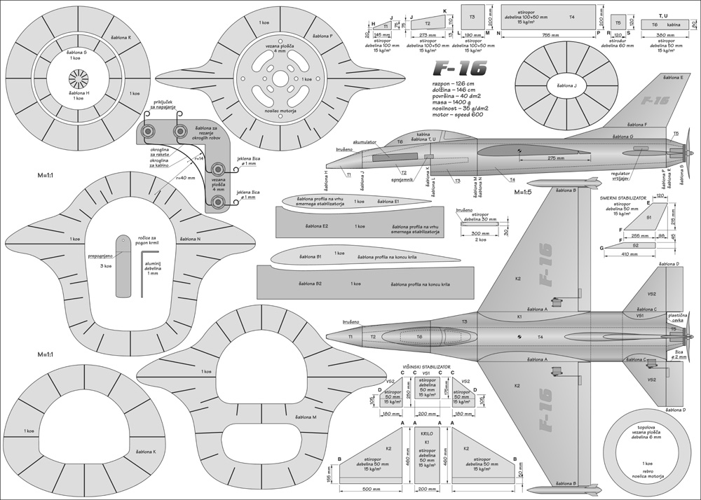

I'm trying to go from something like this mosquito bomber in 3D to 2D plans like the F16. So I'm trying to convert a 3D model into a 2D one. Although my parts aren't as extremely angled as the mosquito. Mosquito would be quite difficult to reproduce I think.
Step 1 will be to make an accurate 3D model of the Mosquito.
Step 2 is making the required section, and detail views to create the 2D drawing(s).
Going directly from an isometric image file as shown, to the 2D drawings as shown is not something which can be done with the press of a button, or even several.
A talented Artist might be able to draw the 2D work "by eye" from the isometric image.
It comes down to the constraints of accuracy, time, talent, and budget.
