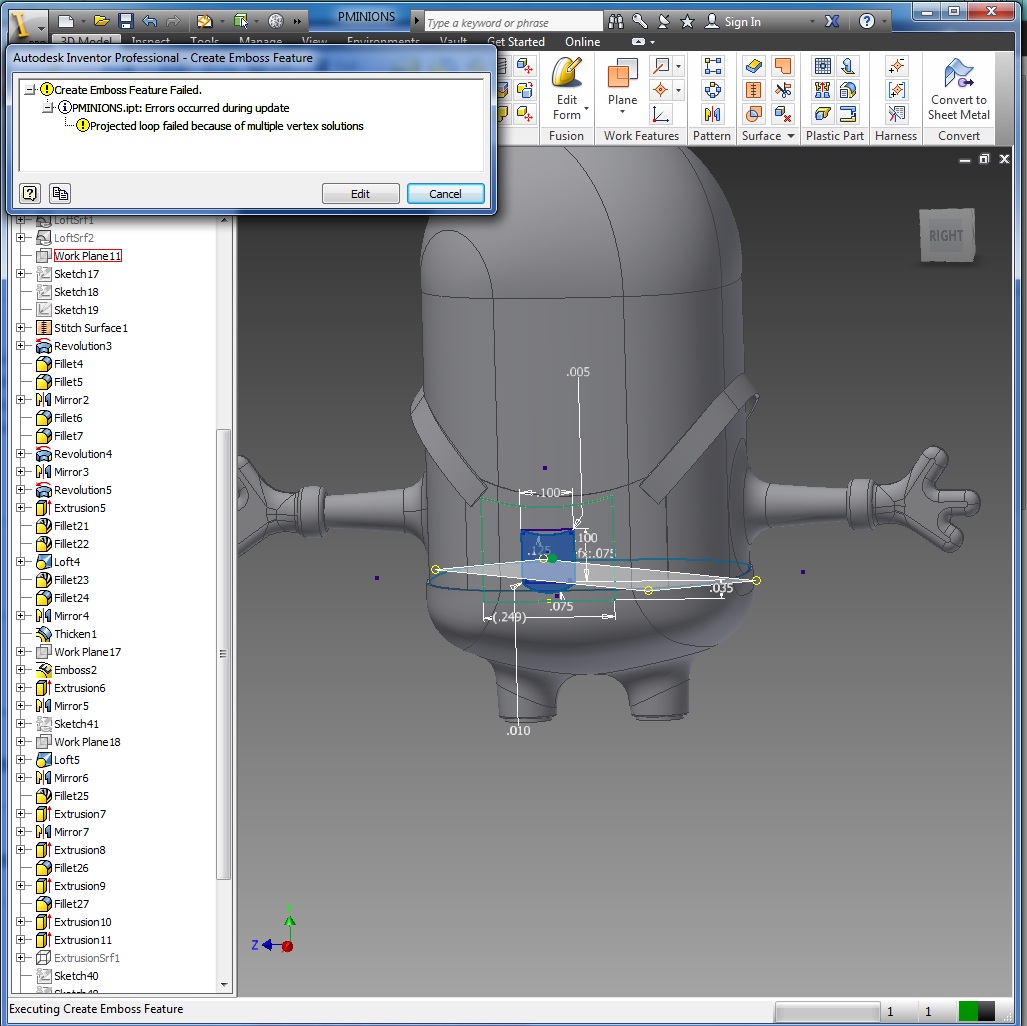

I am trying to emboss a shape on to a surface but of this error:
Projected loop failed because of multiple vertex solutions.
What do I do and how do I fix it? Thank You.

jejejeejej im also made a minion jejejej mmm you can copy and divide that surface to use only one surface and inventor should let you use that single surface to emboss waht you want...... i think it can work ... try it
You will continue to get this error that looks like is a multi-surface import not a sold part.
You need to stitch all the surface together together, then give then some thickness then emboss
