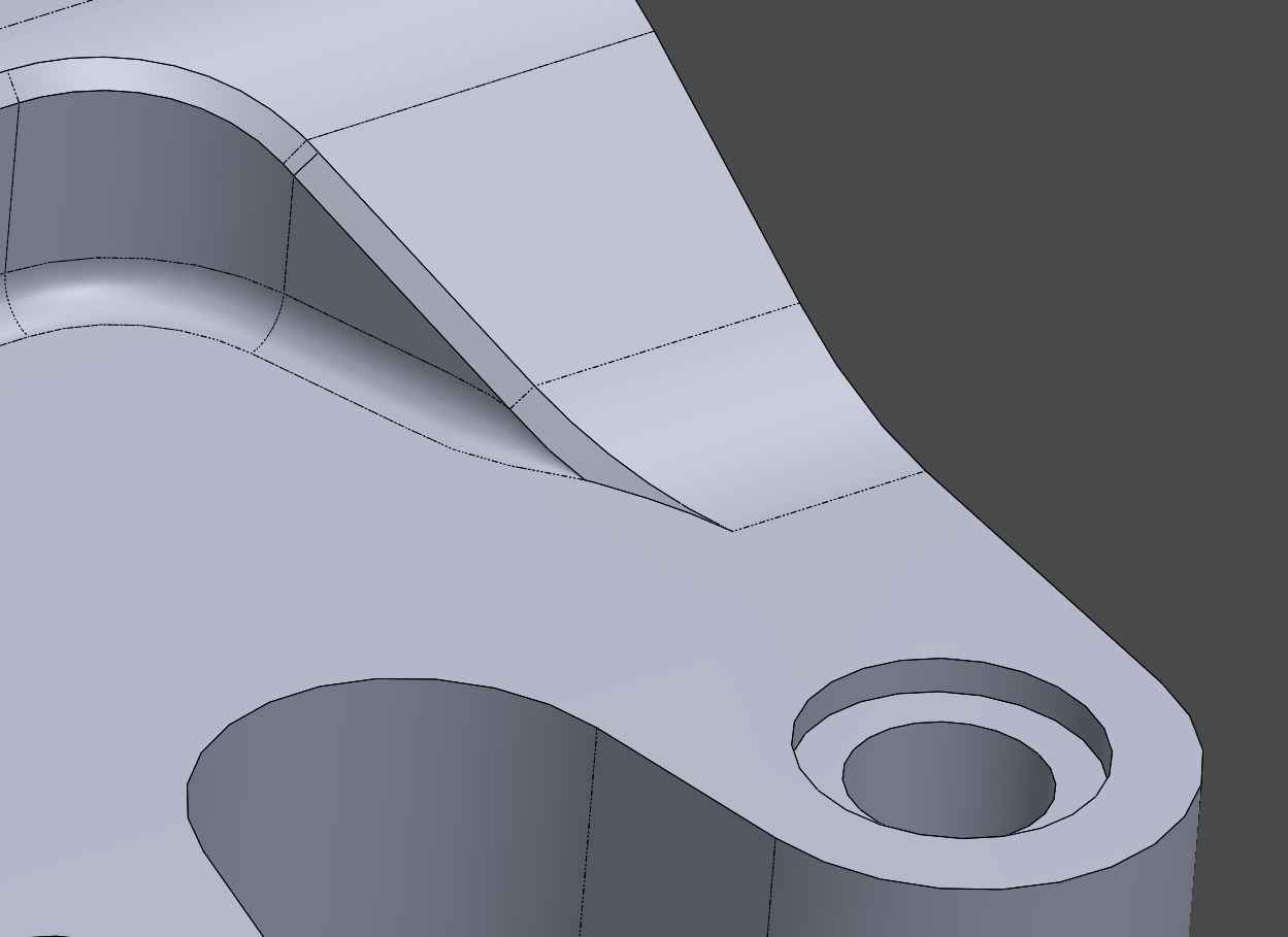

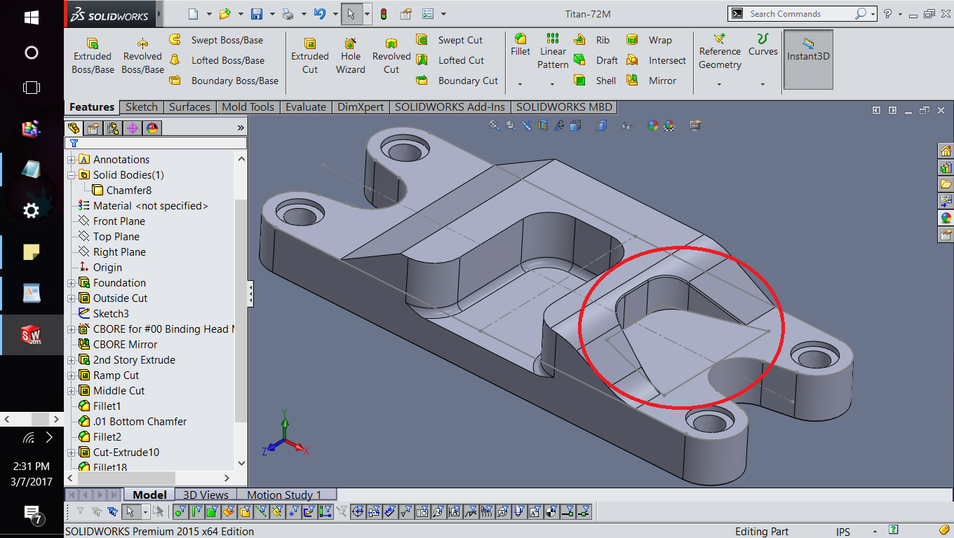

I've uploaded the part and files. The fillet and chamfer are not merging like in the geometry of the blueprint.

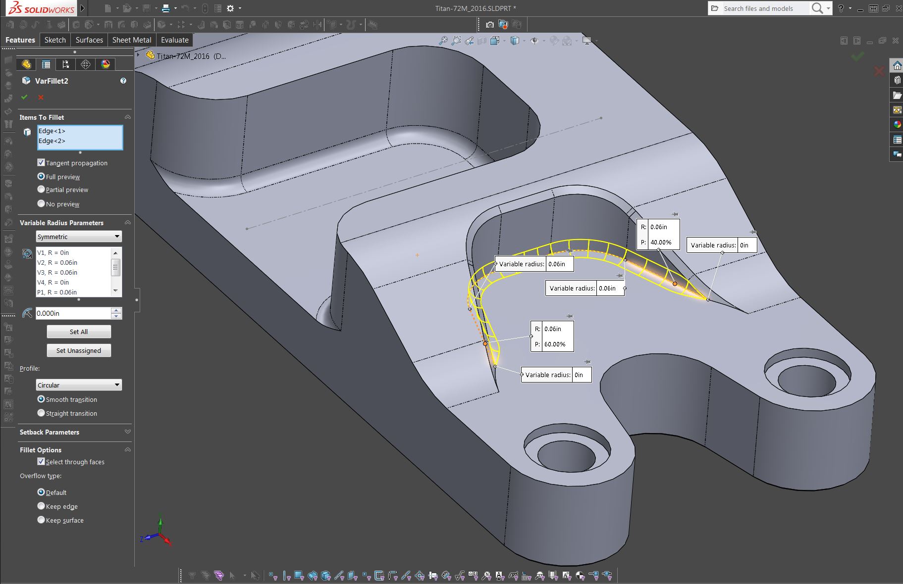

This one is kind of a booger. The closest I've been able to come to looking like the model in the PDF is by using a variable radius fillet. I'm not sure how nice that plays with a machined part though. Also I changed the chamfer on that edge to .025
