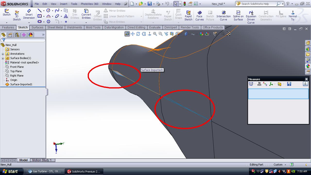

Bad Surfacing. Also Bad luck I have SW 2012. Thanks to IGES. There are some surface gaps you need to fill. I had fixed the IGES file somehow. You can try to fix the SLDPRT yourself after checking what I have done.
After fixing all you need to do is Knitting the surface & it will create the solid you want.
