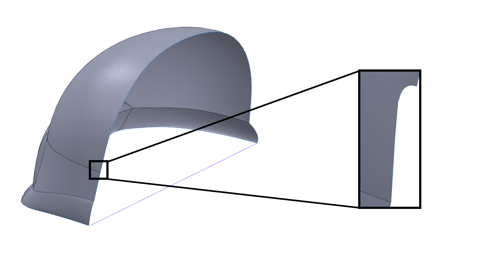

How do I create a solid from this surface? Soumya Khanna 16 May, 2019 07:58 AM I'm trying to make a helmet. I've made the surface model (pretty crudely, I'm new to surface modeling) and now I'm trying to get a solid. Thicken feature doesn't work, neither does offset. Help? helmet2.SLDPRT 1 Answer FredSWUG Answered on 16 May, 2019 10:20 PM There is a small defect in the model. See attached image. Defect.png
