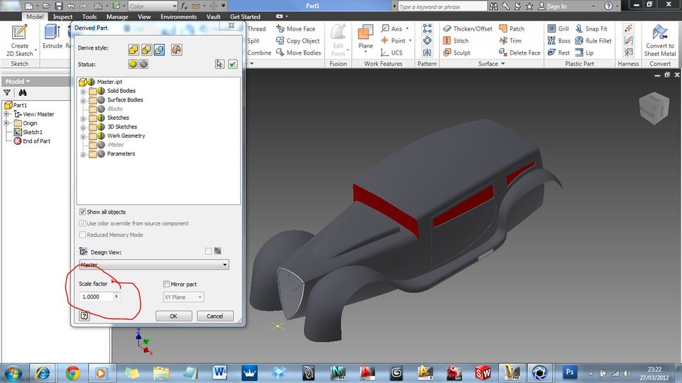

How do I scale a model in Inventor?

Thanks for the tutorial.
I have a somewhat related question:
I am trying to make a shell of a mesh feature after I have upscaled it.
The regular shell technique isn't working as a mesh feature has hundreds of surfaces. So, I decided to open the file with my part in it and then derive the same part but a little bigger using your method. I would then subtract out the smaller one to make a shell. Unfortunately, when I use this method to upscale, the 2 objects are not concentric so I cannot make the uniform shell that I want to.

Good.But i used this before and some times that does not work in complex features and parts..

There is another way to scale the model in inventor, you can use Inventor Fusion. There is a command scale in there, and than you can back to Inventor again.
