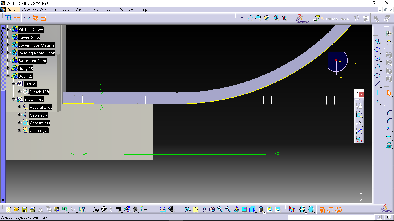

As you can see in the picture I'm how to copy the square along the curve in Catia V5?

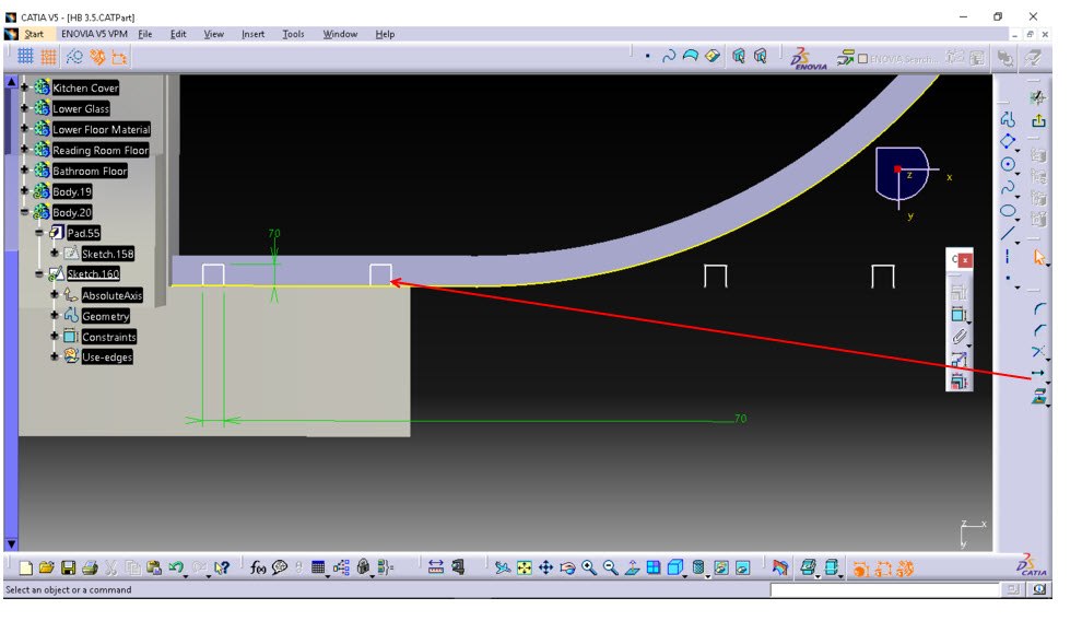

The only way i know how to do this is to use an "axis to axis" translation for every instance you require and project those into a single sketch

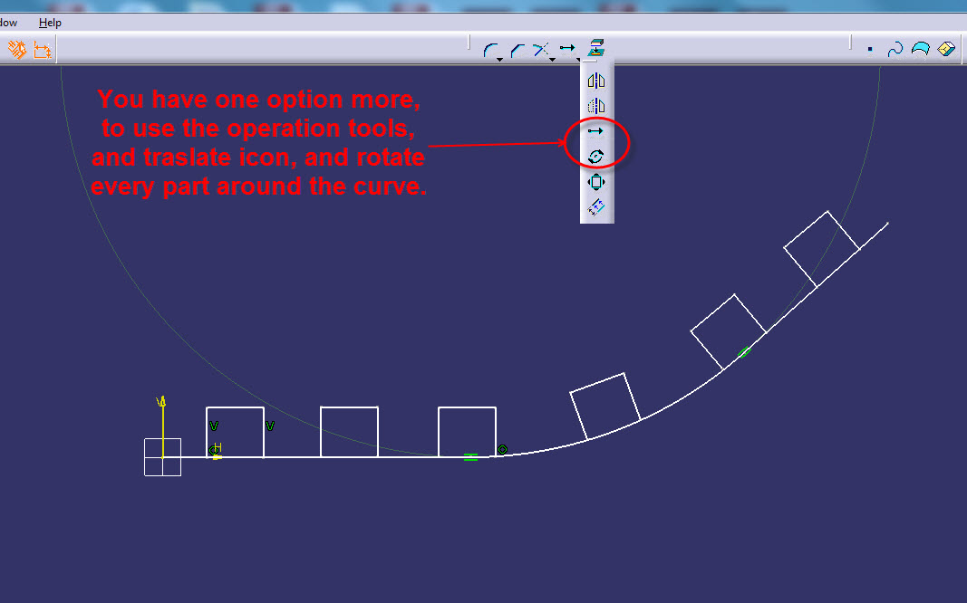

Hi friend, Hope you are having a great day, I am sending you a picture, to solve your issue, I hope my comments have had helped you.
whatever comments, suggestions just let me know!!
