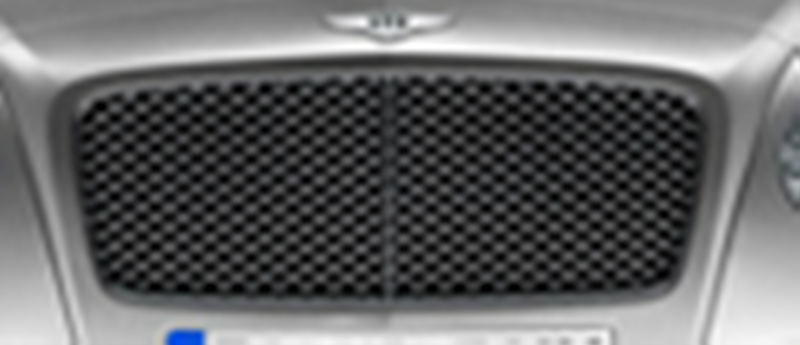

How to create the following part in Solidworks and Catia V5?
How to create the following part of any car shown in the picture. Please click on the picture for a larger view.
2 Answers
Hello Abhijeet!
If you want to make it "real" you have to model every brace of the car front, using pattern.
If you "only" want a car suface-model for rendering, I would only create the surface, choose a good "material" (grate with the same shape) and make an black offset behind the "grate surface". The optical effect is the same.
greetings
If you just want it to look real you can add a decal to your model you can even specify the lighting on the decal to make it look more realistic... I would go this way you dont want to make your model more complex you want it to look real..
