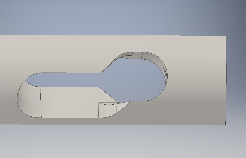

Hello, I need help your help. Please see attached a picture. I am going to do like that using extrude or sweep features in Autodesk inventor but don't know how to do like it.

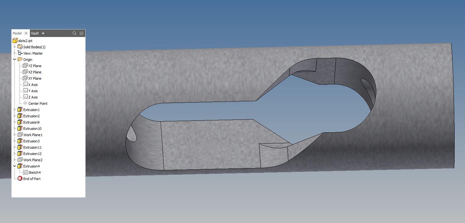

I started to edit your file but it would have resulted in a mess. There are very few constraints in what you have done. It would be difficult to make any edits without throwing something out of alignment. You should never leave sketches unconstrained like this. It's best to start on the default XYZ work planes. My number one suggestion would be constrain everything on each and every sketch before moving on to the next.
You were headed in the right direction and my initial attempt looked similar to what you did. Sometimes the most efficient thing you can do is throw it away and start over. I did.
Instead of trying to work on yours I will let you have my file. You can use it as a guide. I've changed it to match most of your dimensions so you should be able to see what needs to be done. There are 7 extrusions required to produce the twisted slot:
2 simple obround slots that must overlap. (Yours didn't overlap and that was part of the problem.)
4 triangular extrusions. 2 out the front and then 2 out the back where the obround slots overlap.
finally 1 simple round extrusion down the center to clean things up.
