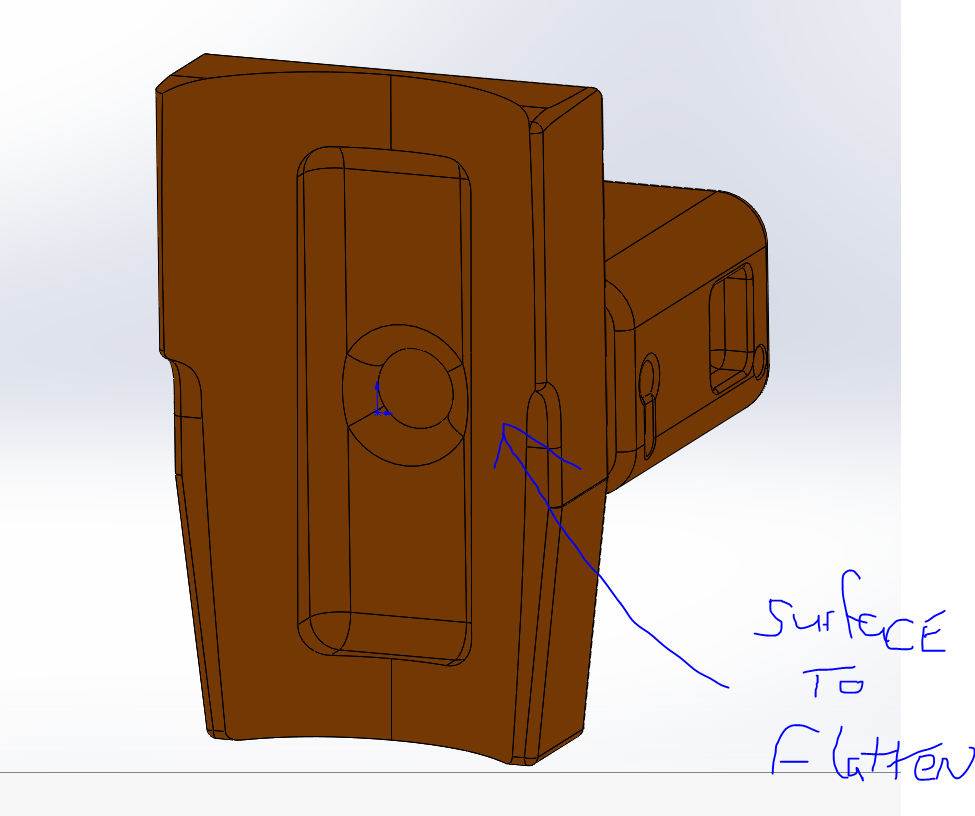

I'm trying to use surface flatten to create A dxf of the attached part but mine is grayed out. New to solid works. Please help.

The issue is that you don't have a surface to flatten. Your model is a single solid body.
- Just select the face you want to flatten (use the Ctrl key for multiple picks)
- Then use either the Surface Knit command, or the Surface Offset tool (set to 0) both tools will give you the same result.
Now that you have a surface, the Flatten Surface tool will work.

Having the same problem. I offset a surface from my solid body and the flatten surface command is still greyed out
Comments 1
https://www.youtube.com/watch?v=4TSKNdHikJk
Couldnt get it to work at the time so I used the above online solution. Probably not a good Idea if this is an everyday task.
