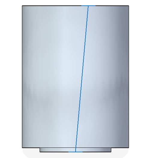

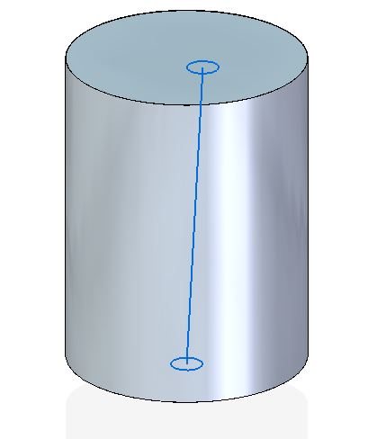

I have a solid cylindrical object in which I need to make a through hole. The blue line in the attached image (front view of cylindrical structure) shows the axis of the hole.
How do I achieve this? Using remove material tool, I can only extrude in a particular plane and it is not possible to remove material at an inclination from flat base. I need the hollow structure to be inclined at 5 degree.
Thanks in advance.
Use Swept Cutout command
