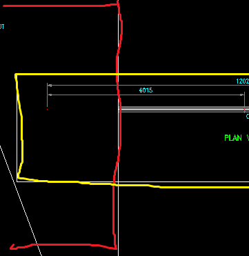

i have 2 overlapping viewports.
1st- red
2nd yellow
objects of 2nd viewport not shown in the overlapping area.
i want it to be visible.
Please help.
thanks so much

Hi Crystal,
check if the objects are made invisible for the view port by doing the following.
1. double klik on the view port to enter the model space.
2. check in the layer manager under the view port column if the objects layer is turned on or off.
let me know if it helped.
