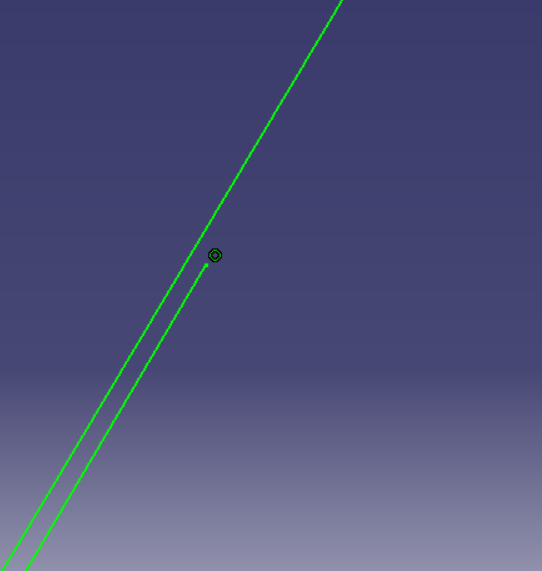

Hello, I'm quite new in this field. As the image shown, I can't seem to connect this two "geometry" even though I resketch it many times. Is it a display issue or something else?
looks like you're asking about CATIA sketches...

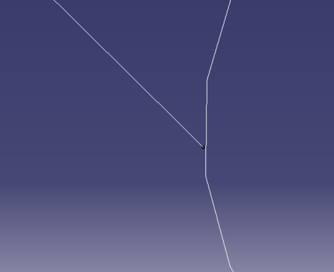

No idea what the image is showing. Please explain what the issue is

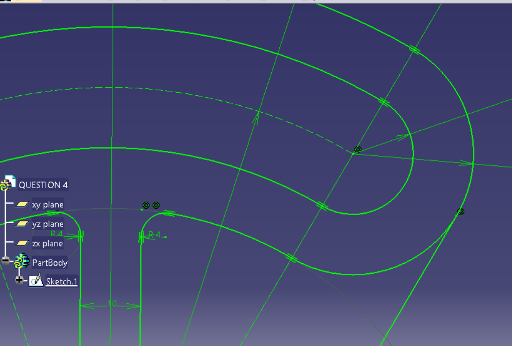

Looks good! Everything is Green, which means everything is fully constrained (fully defined). Every CATIA sketch you make should look like this!

probably OK - you just zoomed in too far so the circle looks like a polygon and doesn't touch the end of the line. One way to check: use the MEASURE BETWEEN tool to measure the distance between the circle and line vertex. if distance is 0, you know you're good.
