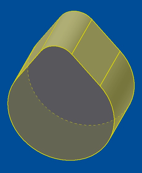

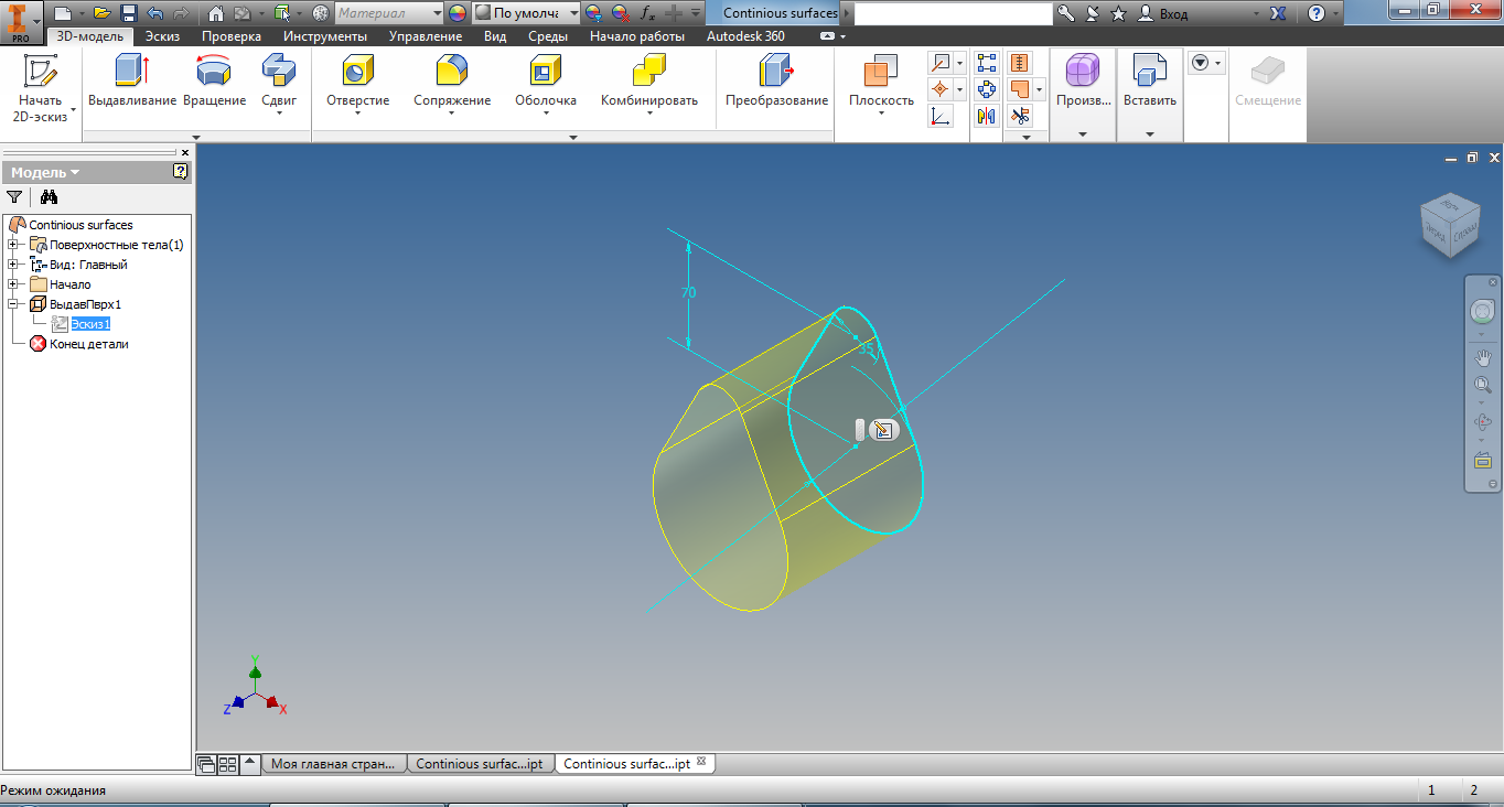

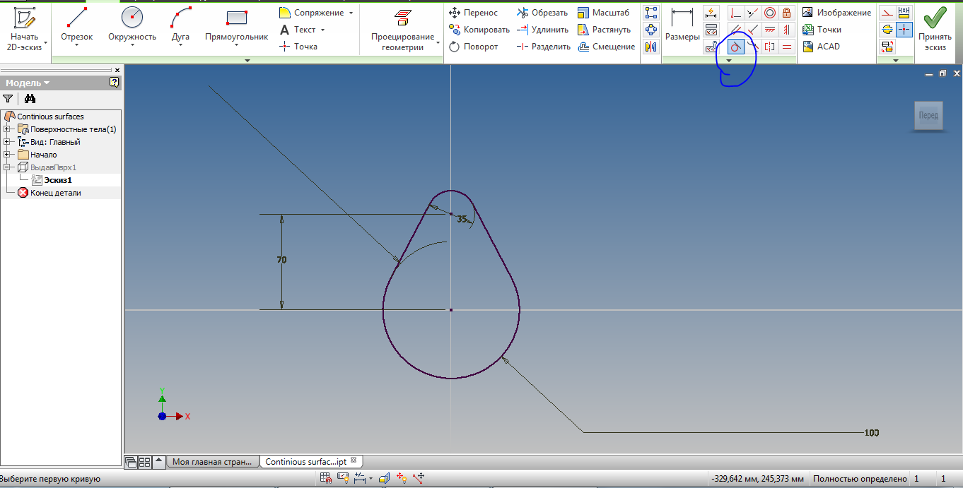

Hi! It is necessary to construct two circles and connect them with lines. The key is to constrain "tangent" between the segments and the circles. The file is attached. The construction of the tree you can see and change settings. Good luck!
