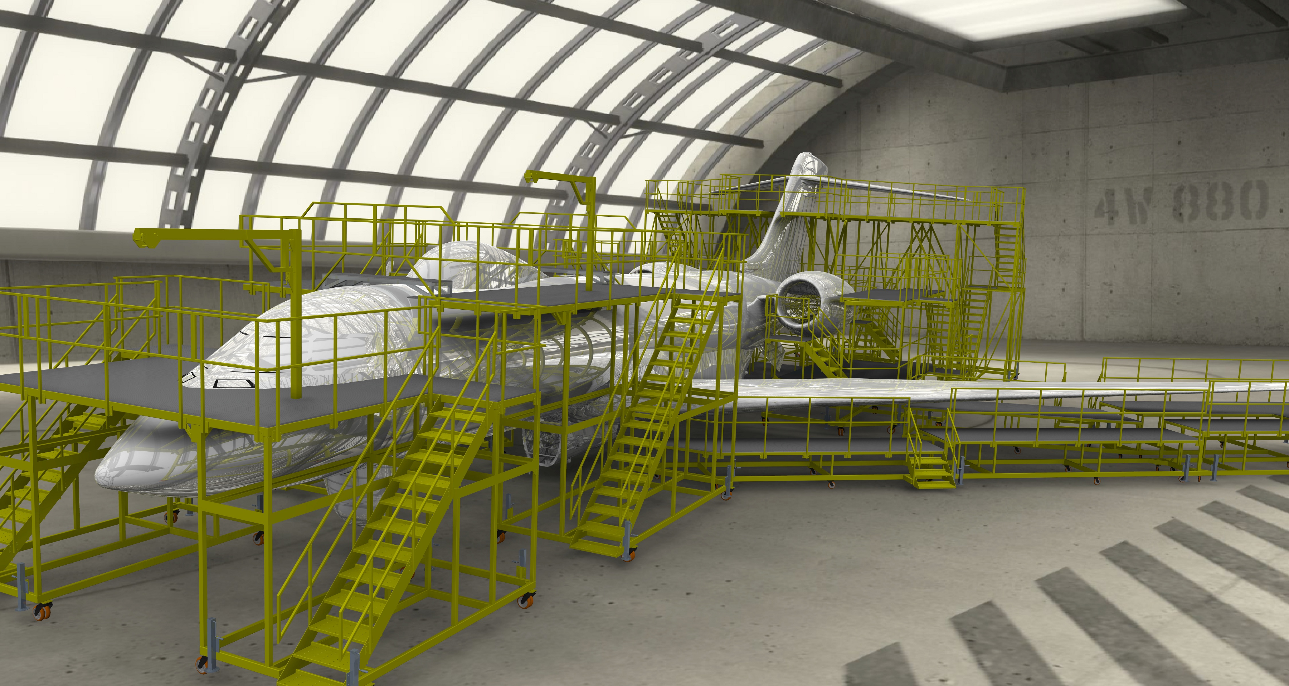

I am about to purchase my 3D design software, and needed to think about which rendering option to choose. I am leaning towards Solid Edge ST4, which means I have the following options:
A. Solid Edge native rendering (need to pay extra $1300 to get "Classic" package)
B. KeyShot
C. Bunkspeed
D. Other free software like Blender/LuxRender etc
Which option would you recommend? I do a lot of building interior shots, which means I need to have control over lighting (e.g. adding multiple spotlights), and Camera (positioning camera, adjusting lens angle).
A lot of people write that Keyshot is extremely easy to learn and use, and can produce great quality shots quickly. But will I be able to add spotlights and position camera in Keyshot?
I couldn't find much literature about ST4's built in renderer though- I suppose it would be the most "seamless" solution, but is it any good?
And are there any free rendering software that can read SE files the way Keyshot or Bunkspeed does?

In keyshot it is possible to create items that emit light! You can make the item invisible to the camera so that only the light it emits is rendered! This means that it is possible to create a light board as used in real photography, make it emissive and then by cloaking the light board with a graduated jpg which can be created in any paint package you can create subtle pools of light! Just search my posts for examples.
Luxion, makers of KeyShot is a Siemens Partner for Solid Edge, and reads in ST4 and prior data in natively. In addition, KeyShot doesn't require an expensive GPU to run properly. It will just works on any machine, PC or Mac. Take a look at www.keyshot.com to get more information, and to see what other people are doing with it.
As much as I like KeyShot, it won't work for you. It can't do interior shots with that much control since the only source of light it uses is the HDRI and light emitting objects. Bunkspeed fails for the same reason (not exactly sure).

Thanks. But is it possible to place spotlights and cameras in Keyshot? Or are the HDR images the only way to control lighting? I render a lot of interior scenes so I need to be able to put artificial light sources in the scene....
Solid Edge does have a very good built in render package, the key is getting to know the commands, once you are used to them then you can get some very good results.
We have just posted our Solid Edge rendering competition winner on our twitter account @PCETECHTEAM, check it out.
Sorry for not getting back and thanks for all the advice. I was tied up with other stuff so things was slow on this end.
Anyway, I went ahead with Solid Edge ST5 Classic package (includes rendering), because I got a good deal and I wanted an integrated package native to Solid Edge. I only had time to try it briefly the other day, but it didn't felt good, but maybe that's because I am not familiar with all the settings yet. I'll need to play around with the settings a bit more, but if I am still not happy with the results then I may need to think about getting Keyshot or Bunkspeed.
