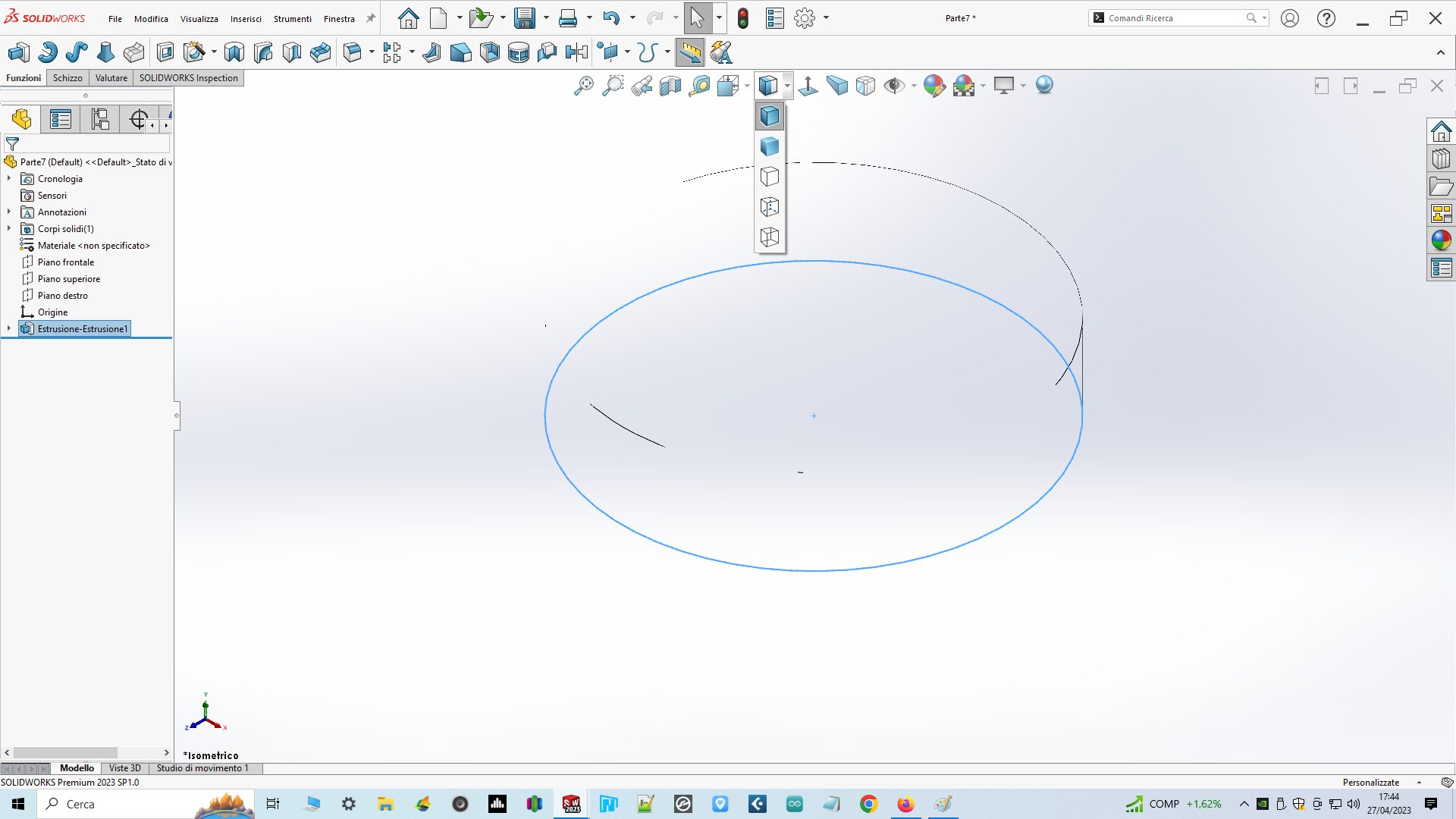

Hi all, opening SW 2023 the first part is correct but the second, same setting as the first, is transparent. How resolved? Thank you!
This is a video driver issue. I have this problem at work (on SW 2021) and at home (on SW 2022). Unless you want to go through the hassle of getting a "certified" card for Solidworks, you'll just have to deal with it. I've found that when a part goes transparent like that, all I have to do is click a surface on it and that brings it back. Otherwise I zoom in and out and that fixes it most times too. Rebuild doesn't seem to fix it most of the time.
