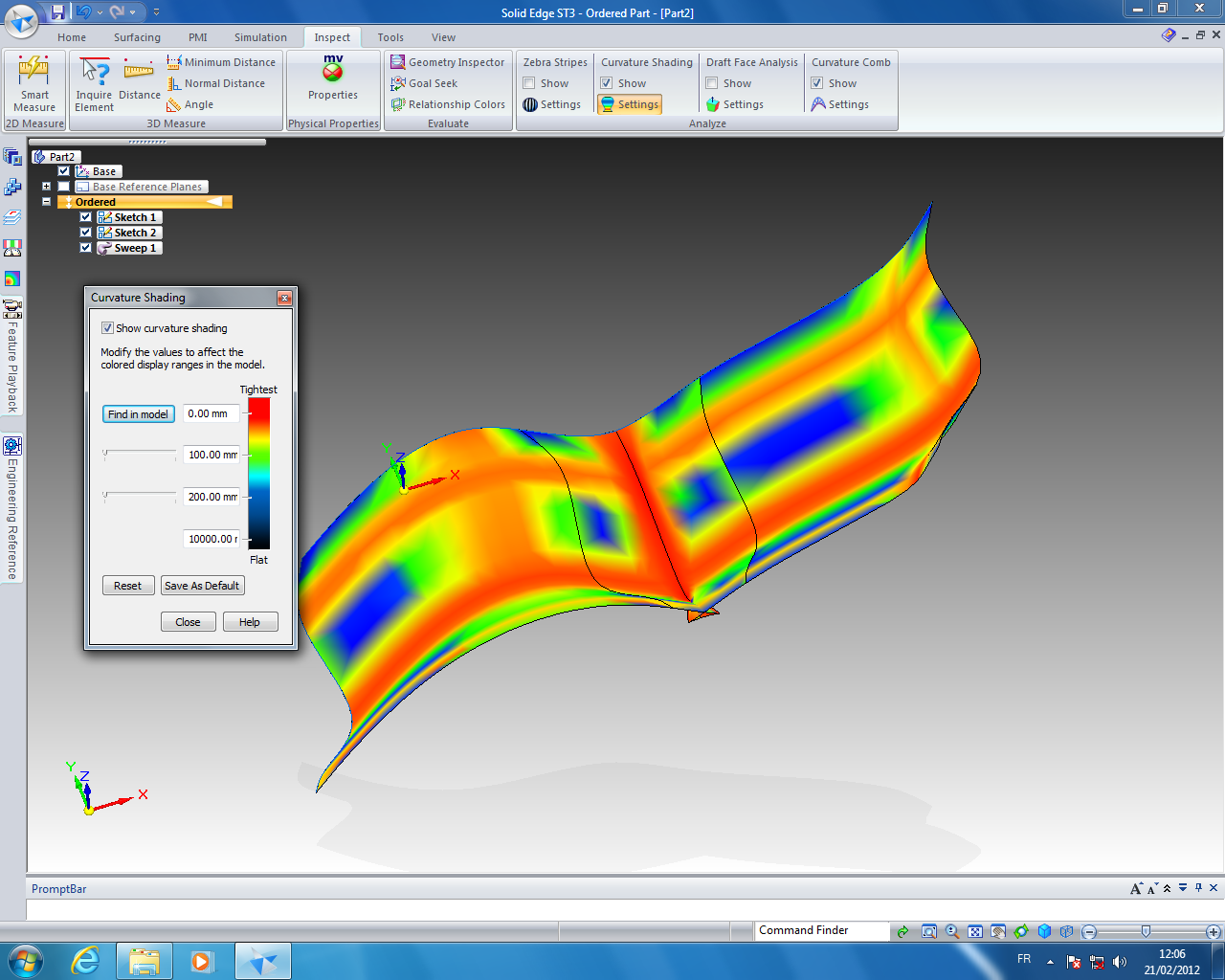

surfaces are probably poorly smoothed. There must be a tiny bump somewhere.l'épaisseur ne peut pas être supérieur au rayon minimum. Or create a thickening thickness 0. A you tried thickening of 0.001 to see if it ok?

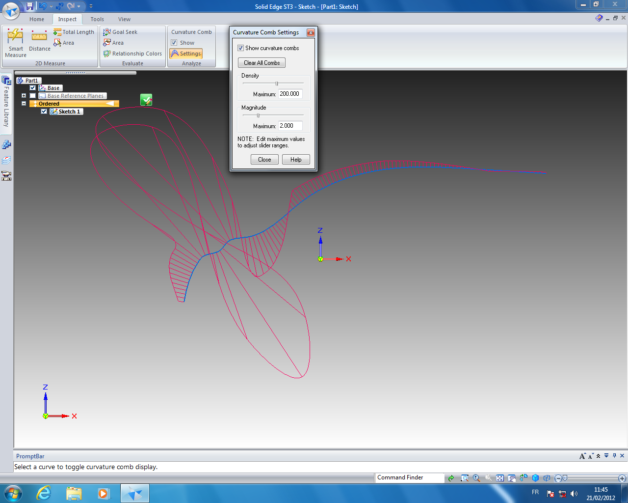

more points you have to define your spline, you most likely to encounter this problem. The option curvature comb boosts to find out where the problem

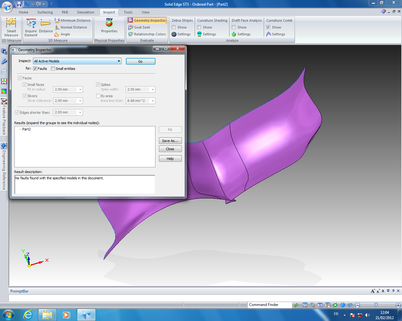

To find out what the problem you can also use the inspect/Evaluate/geometry inspector or inspect/Analyze/ Curvature Shading/Settings/find in model
