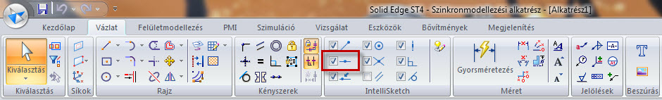

Hi all! Where is it possible to add midpoint snap while doing sketch in Solid Edge? Can anybody upload a quick screenshot please. Thank you!
Toth already answer it :)))
And don't forget your mice! ;-)
Hold down the "M" key when clicking and it will select only the midpoint. Use "I" for intersect, "C" for center or "E" for endpoint.
