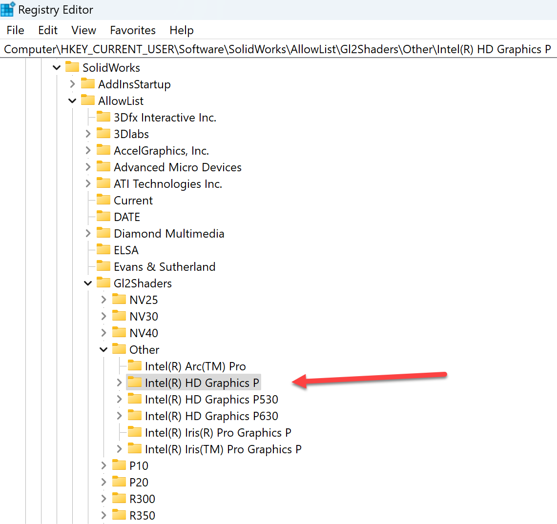

I've gotten this to work for Intel cards. It was a simple mater of renaming the key illustrated in the attached image to whatever the name of my machine's graphics-card.
I see that there are plenty of Nvida options there to under the NV*-keys.
