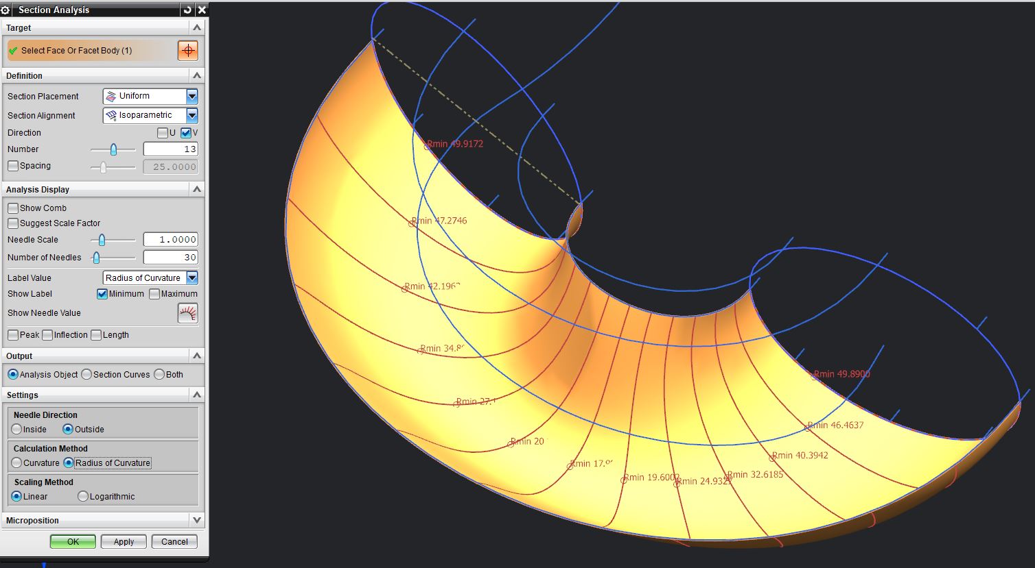

surface
5 Answers
In NX, use the "Section Analysis" tool set to "Radius of Curvature", then decide the definition of the check; isoparam, planes, etc..
"You can create planes and make skech in this planes with the intersection of your surface to be measured. This option will create a line that you can then compare with others and know the angle diff..."
https://grabcad.com/questions/how-can-i-check-the-angel-radius-and-depth-in-catia-v5
Credit: https://grabcad.com/vicen-1
