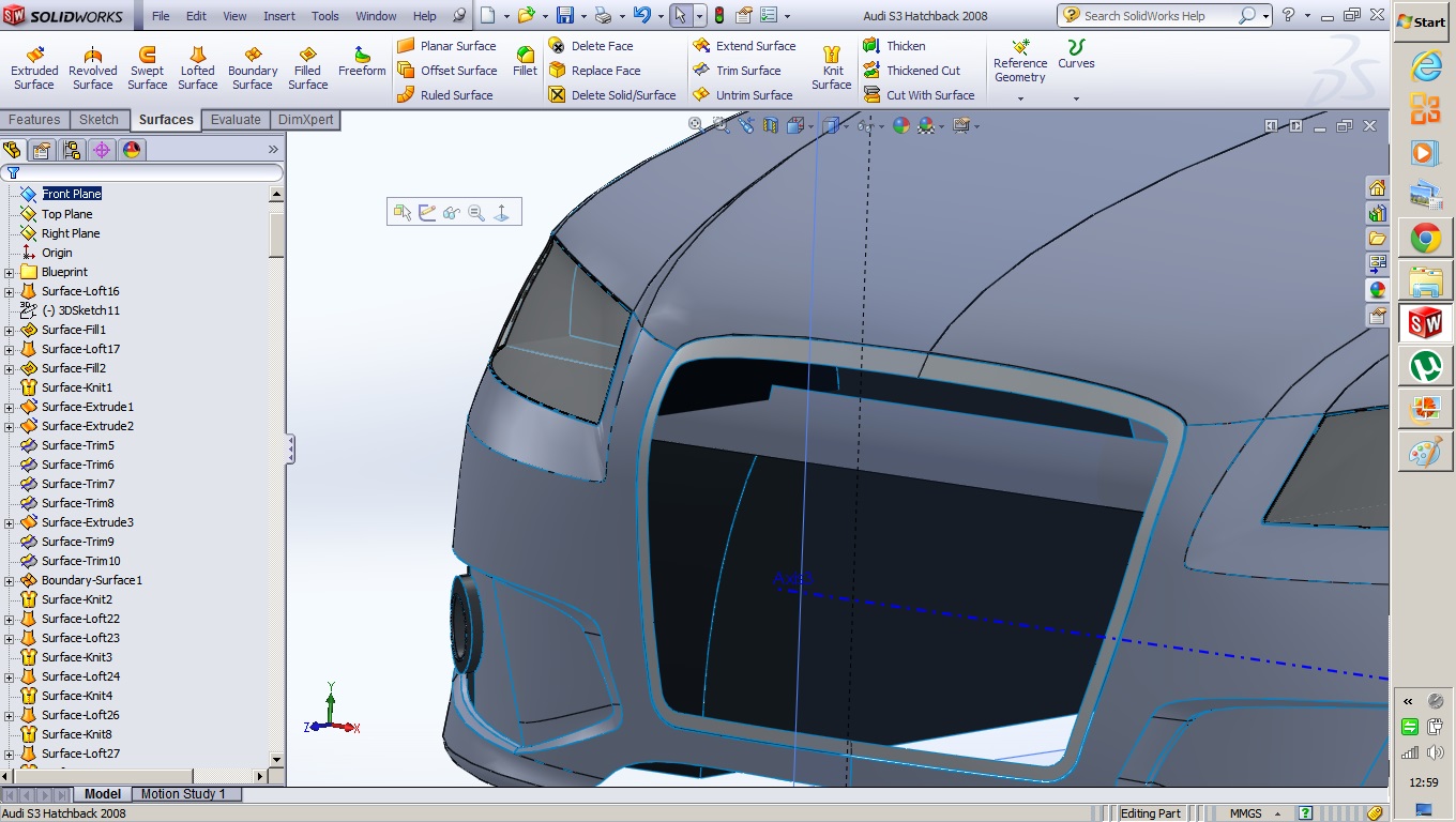

I'm a student, and i'm busy with my own hobby project at the moment.

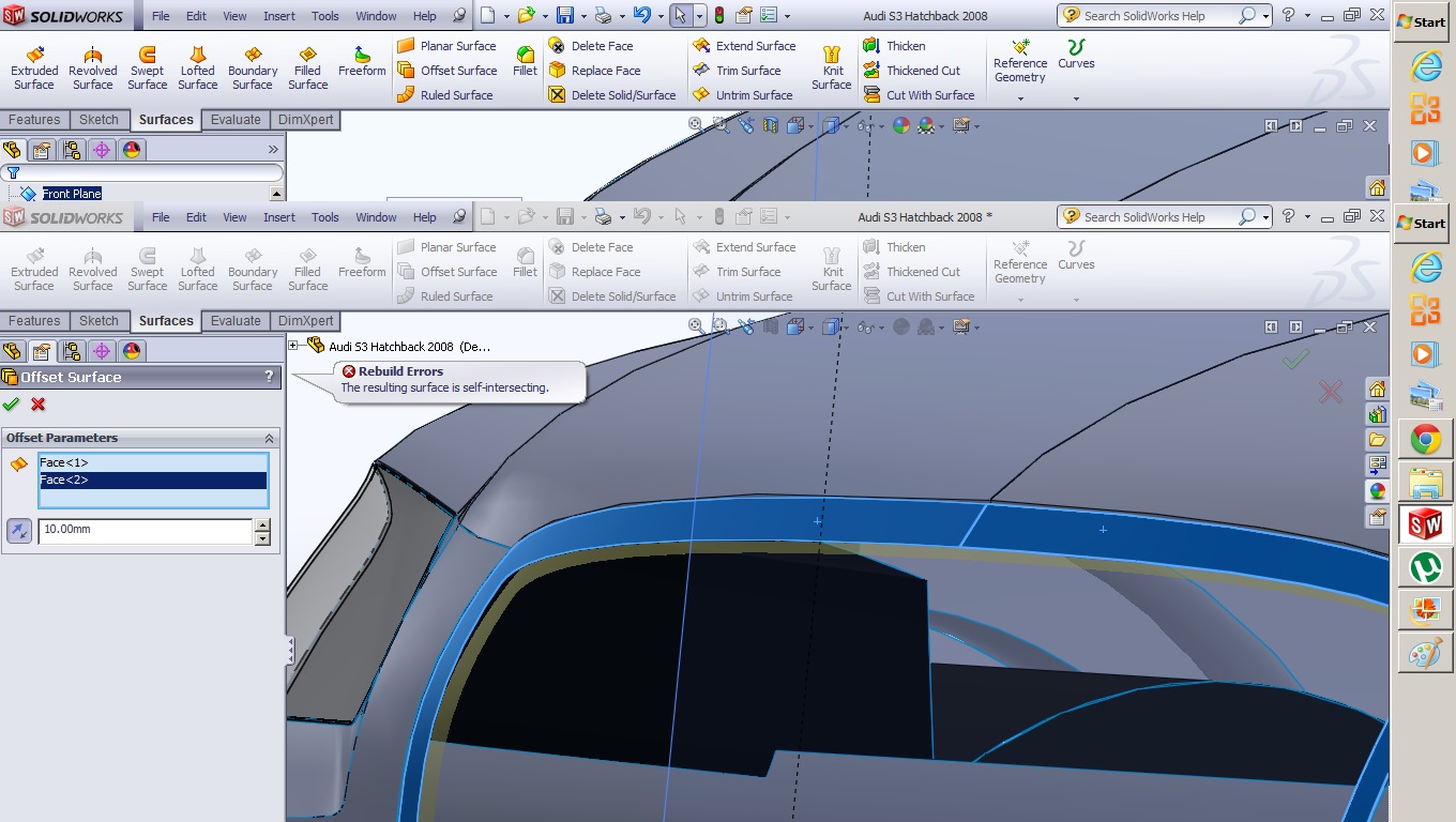

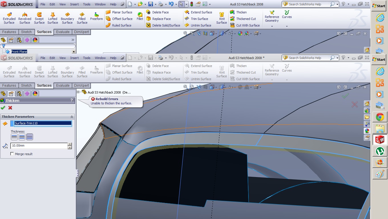

But the problem is that i can't thicken some surface's.
And also i don't know what the problem is.
It gives an error (unable to thicken the surface).
I have also tried this:
- offset surface and make that thicken but the problem is that i get only the half thicken.

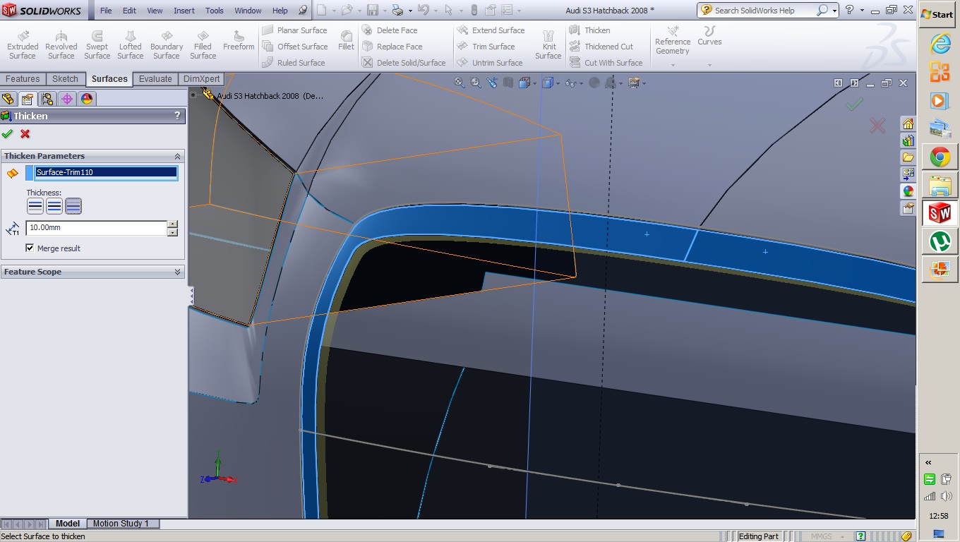

My wish:
I want to thicken the surface and at some nice fillet.

I think that there is a simple solution which you can try. just Un - tick the " Merge result" box and, retry your thickening procedure.
