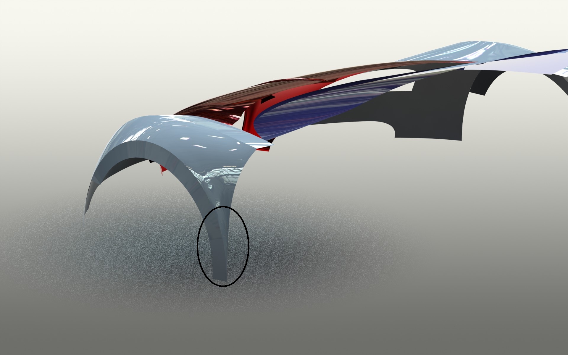

I'm new with surfaces modeling in SW. I'm modeling a Bugatti Veyron and I'm having some problems with the fender. It's bending too much on the inside (see picture). To all my fellow SW surfaces modeling experts can you help me to solve this problem. Thanks in advance

HI John,
I'm guessing you are using the boundaries feature? If so, try to set it to different settings like global, linear etc.
If it doesn't work, send me the file and I'll take a look for you.
