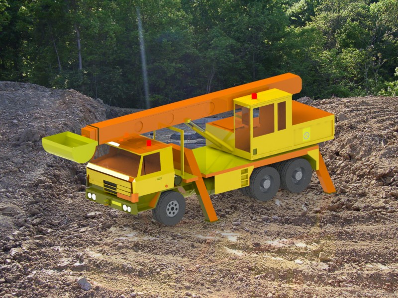

Tutorial : How to import Google sketchup in to solidworks ?
Here is a short video how to do it. http://youtu.be/KyI-V4NLs28
You can find exported files here : Tatra 815 crane Sketchup to SW tutorial
Have a look on this model how good or bad this method is.
It work only with sketchup PRO.
The import time can be more than 30 minute and more.

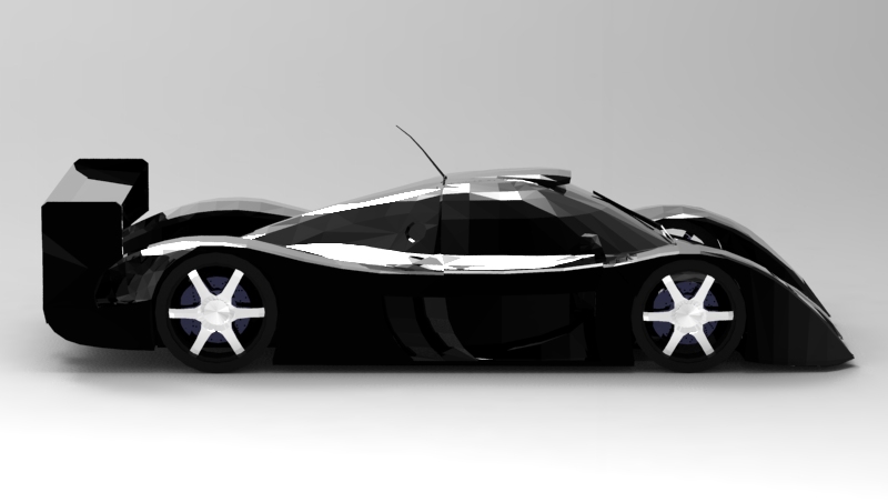

"If" you happen to get a nice model to import into SW, the result is not very good. the disconnect between polygon models and, well, everything else is just too much to interpolate. A model looks like this if it has a lot of curves.

Mesh to NURBS is the #1 most mis-understood problem in the entire 3D graphics world, and especially on forums where most people have little understanding that this process cannot be done. I get this question 3+ times every day since 1996 and write a 5 page response to all people. Rather than send that longer + more detailed response, I'll refer to this posting. Most people on forums don't believe my comments but that is due to lack of understanding about mesh vs. NURBS/solids data. There is no magic to importing mesh data into SolidWorks, and all those cheap plug-ins from India just pull the wool over your eyes. My IGES exporter has the same "trick", which I added in 1994, to turn each triangle into a bilinear NURBS surface but that would never be used by anyone.
