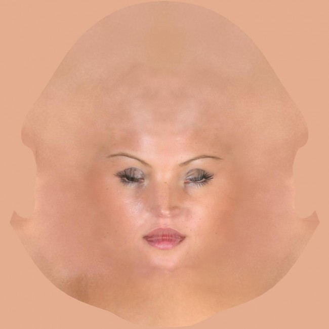

    Fast and simple inside KeyShot. Tiho used a variety of textures and materials exported from DAZ 3D. Here’s a sample of what bump and color maps he used after bringing the model into KeyShot and applying the materials.
