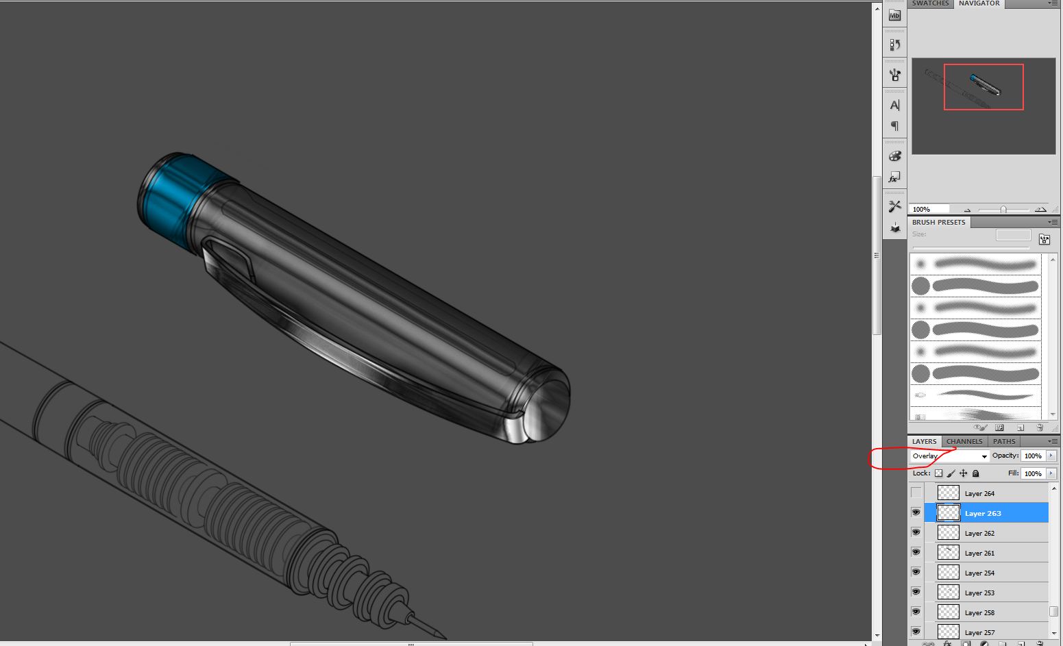

    Isolate the cap at the end fill with blue and set blending mode of layer to overlay
  2. Step 2:

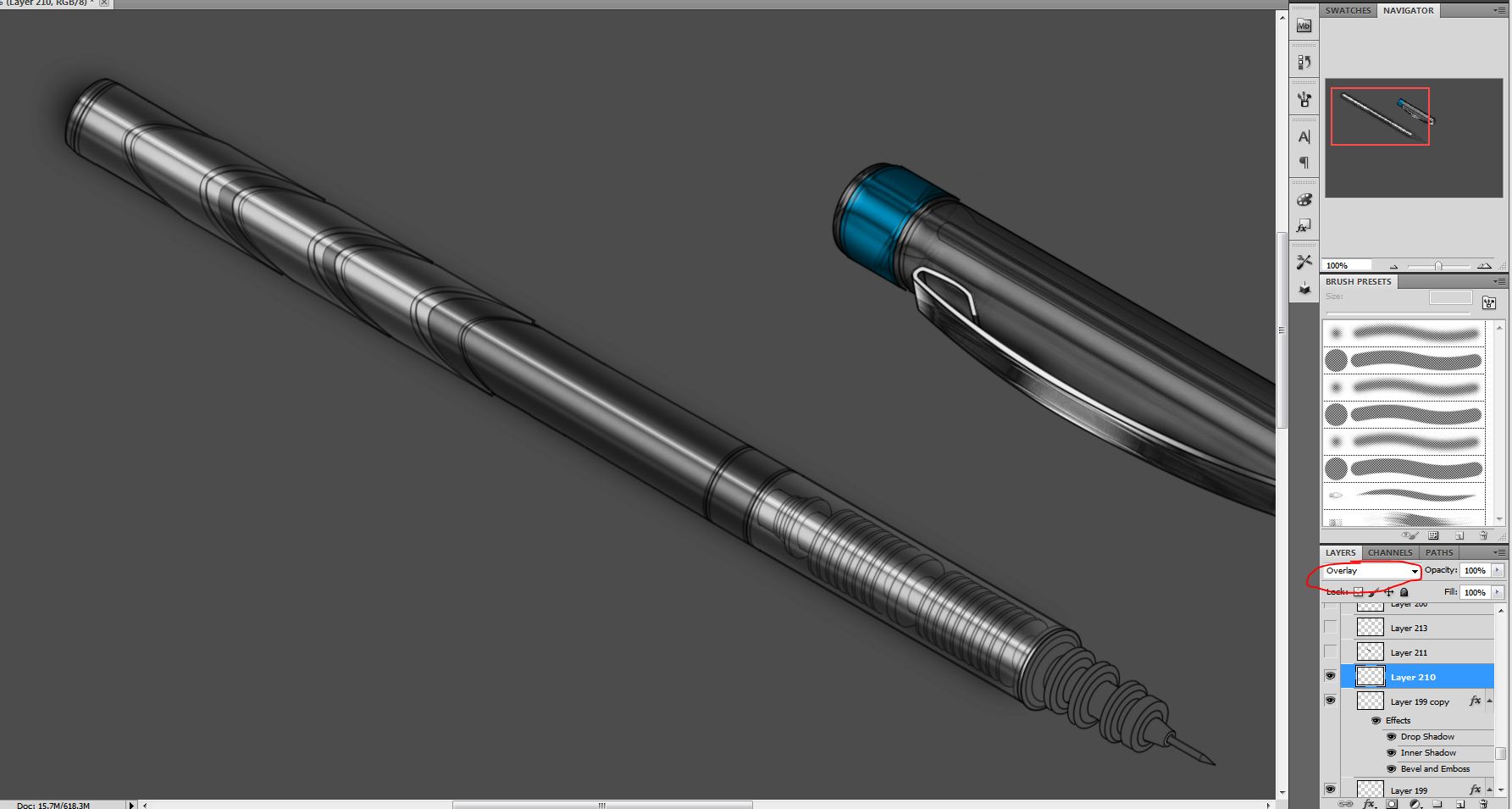

    Now for the pen part. Just like before. New layer get a nice smooth brush white color set blending mode to overlay and crate highlights for the pen
  3. Step 3:
    Ad some effects and BAM!
  4. Step 4:

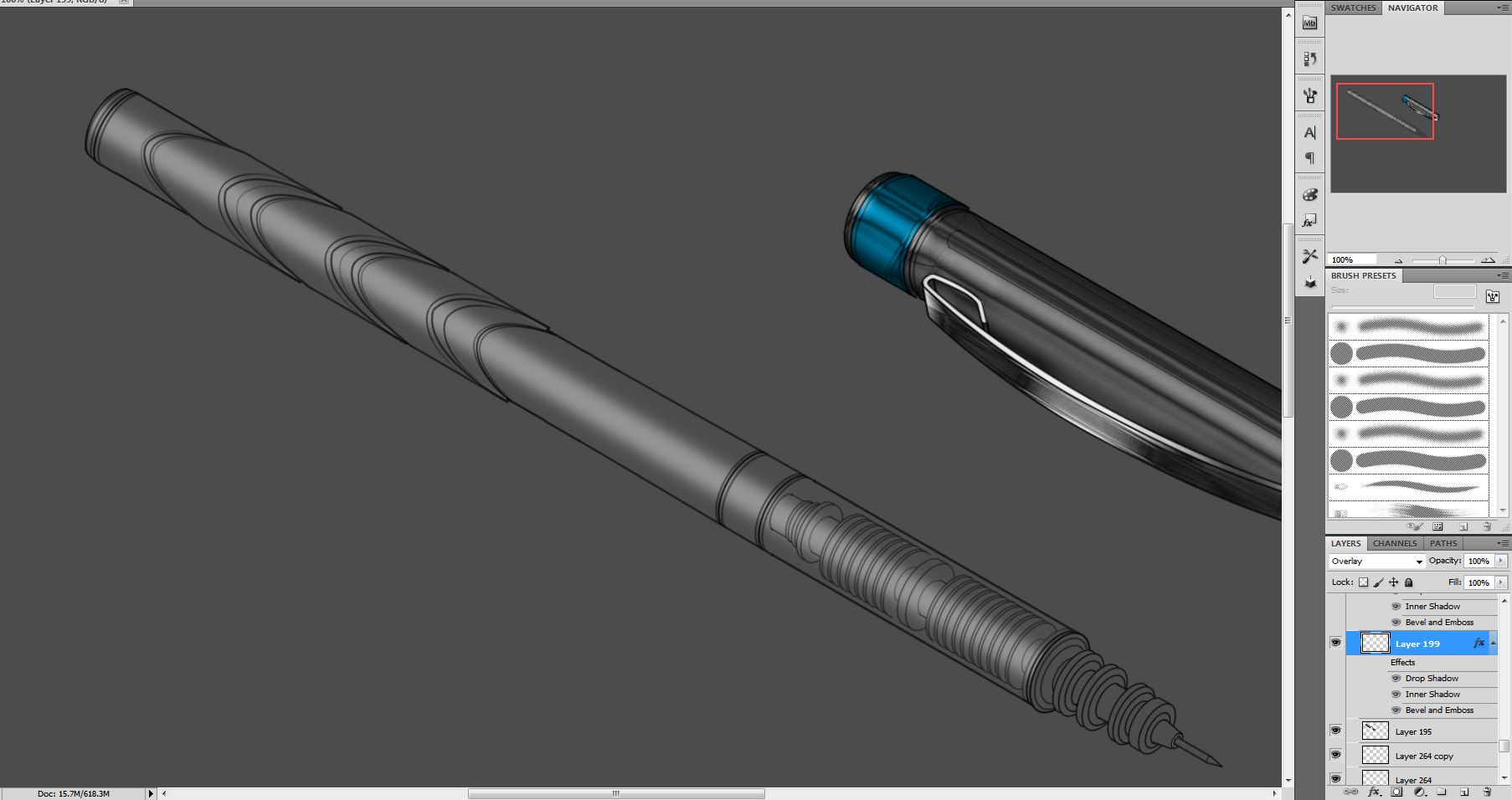

    Drop Shadow
  5. Step 5:
    Inner shadow
  6. Step 6:

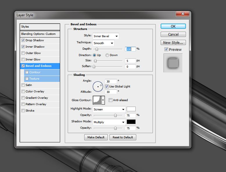

    Bevel and Emboss
  7. Step 7:

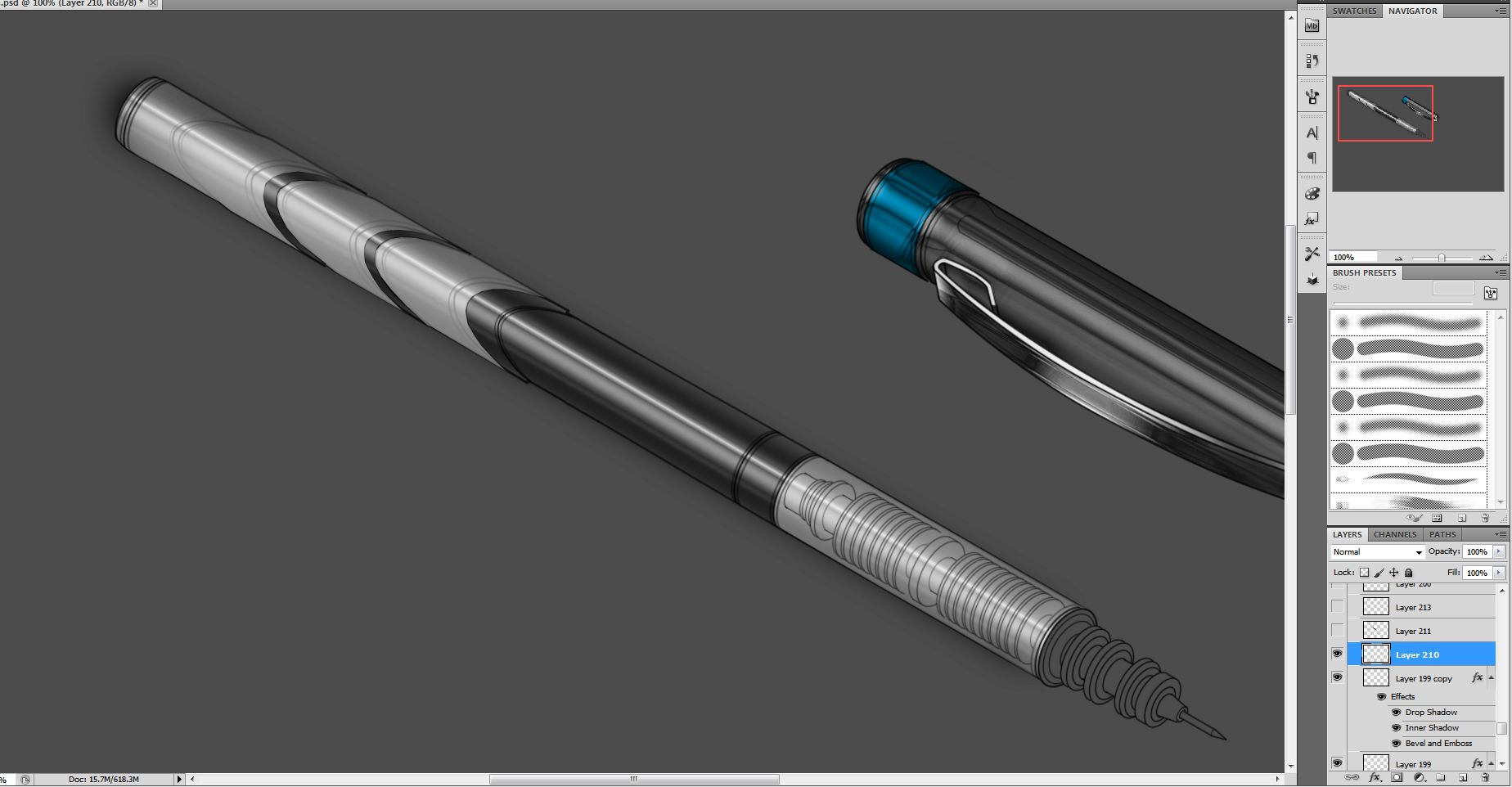

    New Layer fill with white and set blending mode to overlay. this will enhance the highlights more
  8. Step 8:
    Select specific area new layer fill with white and set to overlay
  9. Step 9:
    overlay
  10. Step 10:
    Select specific area, new layer, Hold ALT Layers tab merge visible. you get his
