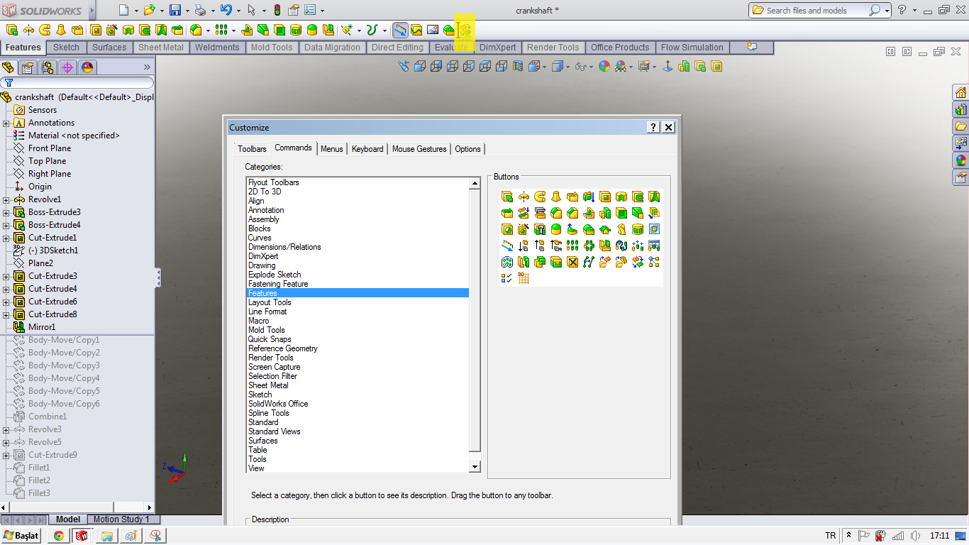

using 'move copy body' command for coping
(if you have a problem with this command, follow the tutorial. if not, go to next part)

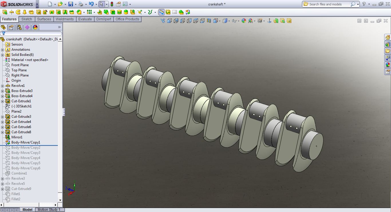

  1. Step 1:
    follow the steps up to here

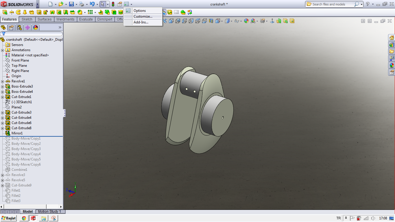

  2. Step 2:
    click on options--customize

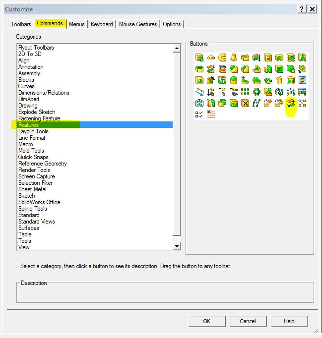

  3. Step 3:
    find this command
  4. Step 4:
    drag and drop the command on the command manager

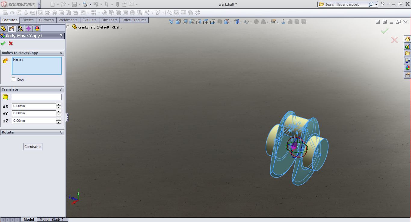

  5. Step 5:
    click on the command

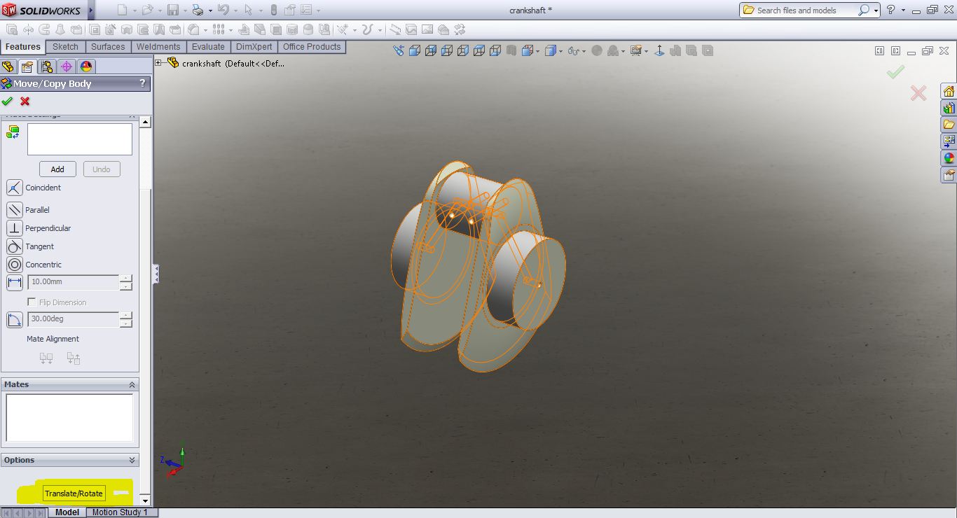

  6. Step 6:
    use this button
  7. Step 7:
    select the body

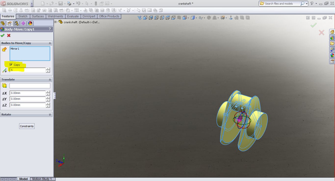

  8. Step 8:
    make the copy box ticked and enter 5
  9. Step 9:
    now we will change z coordinate. enter the shown value (95mm)
  10. Step 10:
    confirm that and replicated body is ready.
