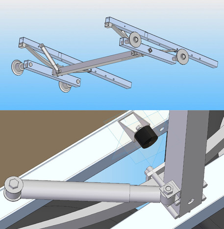

The current design
- The trailer doesn’t withstand a load well (50x50mm steel profiles are currently used between hubs)
- The spring and axle assembly is time consuming to manufacture (welding the threaded rods to the square profiles takes too much time)
- The Axle / spring / shock assembly contains too many parts

  • Axle solution for two pair of wheels
  • The whole system (2 axles) must withstand a load of 1850 kg (4075 lbs) with a safety factor of 2 (meaning 3700 kg or 8150 lbs)
  • The given parabolic spring must be used on both axles (4 springs all together)
  • The given shock must be connected to the axles/springs (4 shocks all together)
  • The given hub must be used (4 hubs all together)
  • The Dimensional references shown on the drawings must be met
  • The solution must be as easy to produce and manufacture as possible. The production volumes are high so saving material and assembly time is very important
  • The Function has top priority over looks of the design
  • The system has to have two separate identical axles
  • Distance between the 2 axles has to remain between 650-700 mm

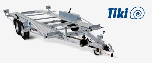

Tikitreiler is manufacturer of trailers under brand name Tiki since 1990 with annual volume exceeding 15,000 units. Currently TIKI has over 50 different trailer models in serial production, as well as various custom made trailers for the transportation of vehicles, yachts, cables, etc.

    We updated the requirements. Main change is the number of axles. The solution must be designed for 2 identical separate axles (4 wheels, 4 springs, 4 shocks all together)

    Could we please get more specifications on the current hub that needs to be kept and the trailer frame. What modifications are you willing to make on the frame? Are the hubs bolt on, or is it a spindle welded in? The current models for the hub do not import correctly, the preview for the solid edge one shows all the profiles correctly but none of the uploaded versions have the spindle for the hub. Could we get a dxf or dwg with the dimensions needed to model the hub correctly.

    The term "torsion axle" is a little misleading to me.
    My understanding of a torsion axle is that the hub spindle is offset from the axle and hence the axle itself acts as the spring in torsion. In this case we are using leaf springs.
    Could you confirm if we are required to use the torsion axle principle as I just described it or are we just designing it with the required leaf springs in mind without the axles in torsion?

    Please Indrek or anyone can we get, at a minimum, the cross section of the chassis and its thickness. It very important if we want to mount the shock correctly. A shock needs to work at am optimal angle to be effective.
    Also because these springs are single point mounts, sideways stability is a risk, we may, depending on the chassis info, be able to use the shock to reduce the problem

    Is there a cross member in the chassis centered over the axles. If so pleas give the position relative to the centre of the two axles.

    I have another question… Observing the parts provided, I’m curious about the implications of the hub (brake drum) and the part called “plaat”. These components are characteristic of a wheel mechanism with brakes, so I’m thinking that the trailer must have a drum-brake system installed. This means that we must not only consider the vertical load, but the braking torque must also be accounted for when calculating the axle’s capabilities to withstand the operational loads. Please confirm this information and, if it’s true, I would need you to provide some technical information in order to calculate the required braking torque. Thanks!

    I'd like to understand better how the hub assy mounts to the frame. There is nothing specific in the images, and I have seen numerous variations on trailers.
