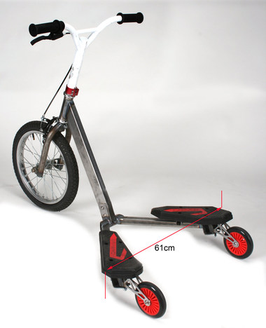

Create a new scooter design for Razor USA.
Solid Edge by Siemens PLM Software is sponsoring the first-ever PowerWing Scooter Design Challenge with Luxion, makers of KeyShot, and popular scooter maker, Razor USA. They want you to Think Radical - use your knowledge, skill and creativity to create the coolest and most awesome three-wheel, side-to-side, body-powered scooter ever.
• The front wheel size could be anything from a BMX wheel (20-inch pneumatic) to a scooter wheel (125mm PU with nylon core).
• The angle and size of the rear casters need to be more or less the same as the existing product 67mm wheel (PU w/nylon core) and 18 degree caster incline angle (from vertical).
• The width of the rear casters should be at least 55 cm
• The handlebar and grips are standard bicycle diameter (22.2mm). The current design is a T style, but a Y style or
other design could be considered.
• The brake is a patented cable-actuated friction brake built into the front fork.
• The steering must incorporate a free-rotating bicycle-type headset (cup and cone) bearing. Bushings for steering are not acceptable for this class product.
• Folding is a plus, but not a requirement.
