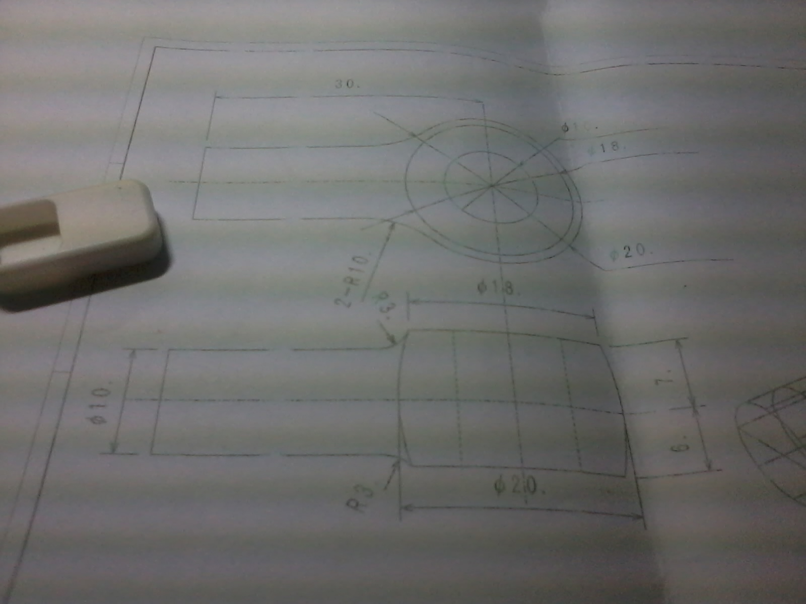

I'm really puzzled how to input the 3mm fillet on the side view and the 10mm fillet on top view of the model. please see image below

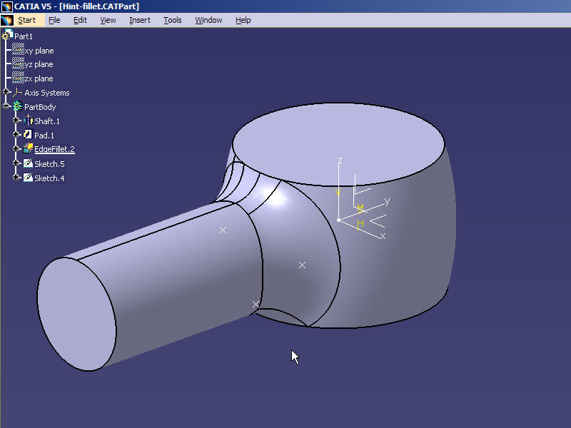

this will help...
Answered with a tutorial: https://grabcad.com/tutorials/catia-part-design
here is the file.
that was really fast man. thanks. btw how did you input those points?

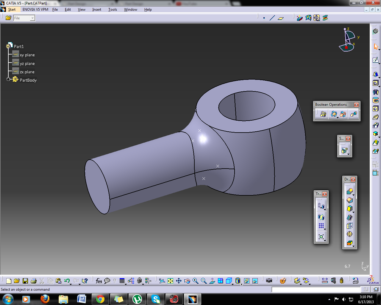

Thanks guys. I was able to do it with the help of 'point on curve' and 'extremum definition'. below is the outcome. I was asked to do different geometries without using gsd. just pure Part design. I'm a trainee in a company using catia. I'll move to GSD after I understood the basics of part design. If you can suggest good tutorials (both part design and GSD) I would really appreciate it. Youtube has a lot of them but doesnt include the audio.
